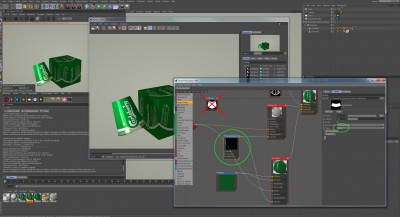

Posts: 16068
Location: Türkiye
sguitton
Posts: 17
Joined: Thu Oct 20, 2016 6:42 am
i send you a scene in private
Posts: 16068
Location: Türkiye
sguitton wrote:i send you a scene in private
This is a good example why you should not use c4d BITMAP rather than IMAGETEXTURE. It propably messed up due your settings in BITMAP to force alpha out.
