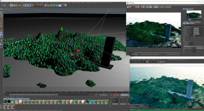

I have got the same Problem, the LV does not show the Instances from Carbon Scatter. The Renderwindow of Cinema renders them with Octane as a Renderer. Using Geometry for 1000000Instaces of Grass will make Cinema 4d Viewport useless.aoktar wrote:Hi NVN,NVN wrote:HI Aoktar!

@MVN, wenn du unter Optionen bei CS2015 es umstellst auf Geometrie, funktioniert es im LV ! Ist aber nicht Sinn der Sache
This is new workflow and faster/reliable and more stable. On old versions it was appearing on just first send and later was disappearing after some changes on object. Becase i was using a copied document on first send and was possible to extract the geometries as render data. But was causing more problems after that and lost after some changes.fireball wrote: I have got the same Problem, the LV does not show the Instances from Carbon Scatter. The Renderwindow of Cinema renders them with Octane as a Renderer. Using Geometry for 1000000Instaces of Grass will make Cinema 4d Viewport useless.
