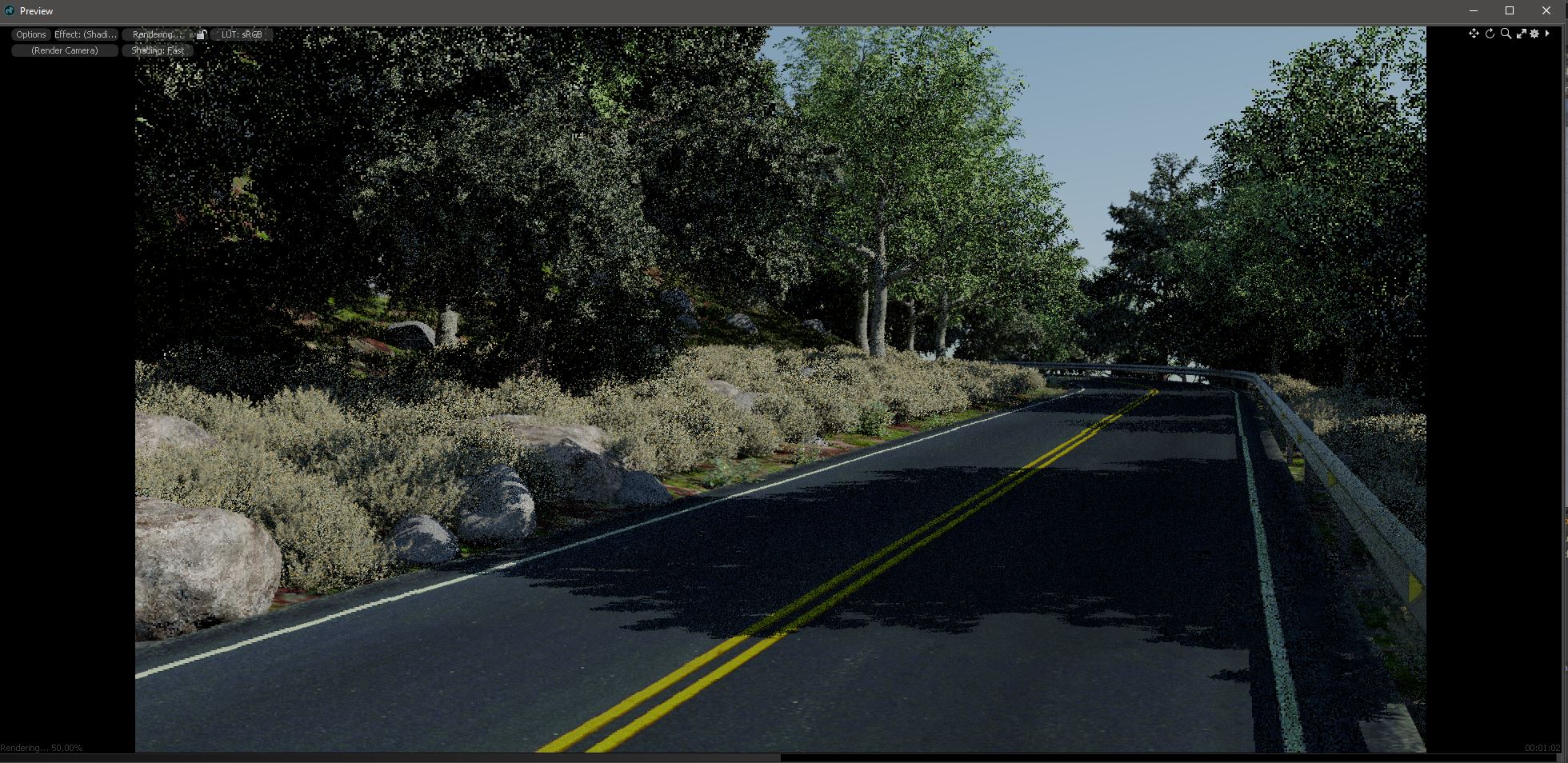

EDIT: I attach a preview of the scene. It´s full of replicators with and animated car on the road and the camera is also animated. Is the problem the scene being too big?

If you are exporting a large animation - export to OCS rather than ORBX (since this will save octane needing to compress the large ABC files into the ORBX file). Which version of the plugin are you using pls? There have been improvements when saving animations with every release, so you need to be using the latest test release as linked in the above post.
