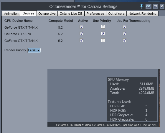

Hi Simon,
I have a general information question regarding GPU Memory.
From the attached, you can see that my Used GPU Memory does come close to my Available GPU Memory.
Is there a setting that I need to look at i order to access more GPU Memory?
Also, shouldn't "Used" + "Available" = "Total" ?
Thanks for your help,
Rick

I think I understand in terms of what is shown as "Available". Not sure I understand in terms of "Used" for the actual render, or if I can increase the "Used" in my render set up to actually speed things up.
If I disable the smaller GPU , as you suggest, would I be doing so via the attached graphic (Nvidia Dialog Box) , or is there some other recommendation, like plugging both monitors into the motherboard (not even sure if this is possible)? Or, are you saying that if I uncheck the "Active" selection for the GTX970 via the Octane Render for Carrara Settings/Devices dialog box, my performance (Used + Available) will go up even though I am utilizing fewer GPUs?
Just curious, does "Used" refer to the limit of what is actually being by Octane during the Octane render, or what is used by the system overall?
R
Performance is obviously based on the number of gpu cores you have set to 'active' on the devices tab. Available memory, on the other hand, is based on the smallest 'active' gpu. More memory will not give you better performance. it will, however, allow you to load bigger scenes. Used is the amount of memory that octane has obtained in order to render your scene. It contains your geometry, textures, and materials plus any buffers that octane needs to do its thing. Used does not include any memory needed by the OS or the Octane kernel. As long as your scene fits in available memory you can render your scene. Any extra memory is idle. If you are tight on memory then you can enable out-of-core textures. This will allow octane to load textures in main memory but it does have a significant performance impact. It is always better if you can fit your entire scene in the gpu. From the example screenshot you posted your scene easily fits onto all three of your GPUs so there is nothing more you can do from a gpu resource point of view to maximize performance.
