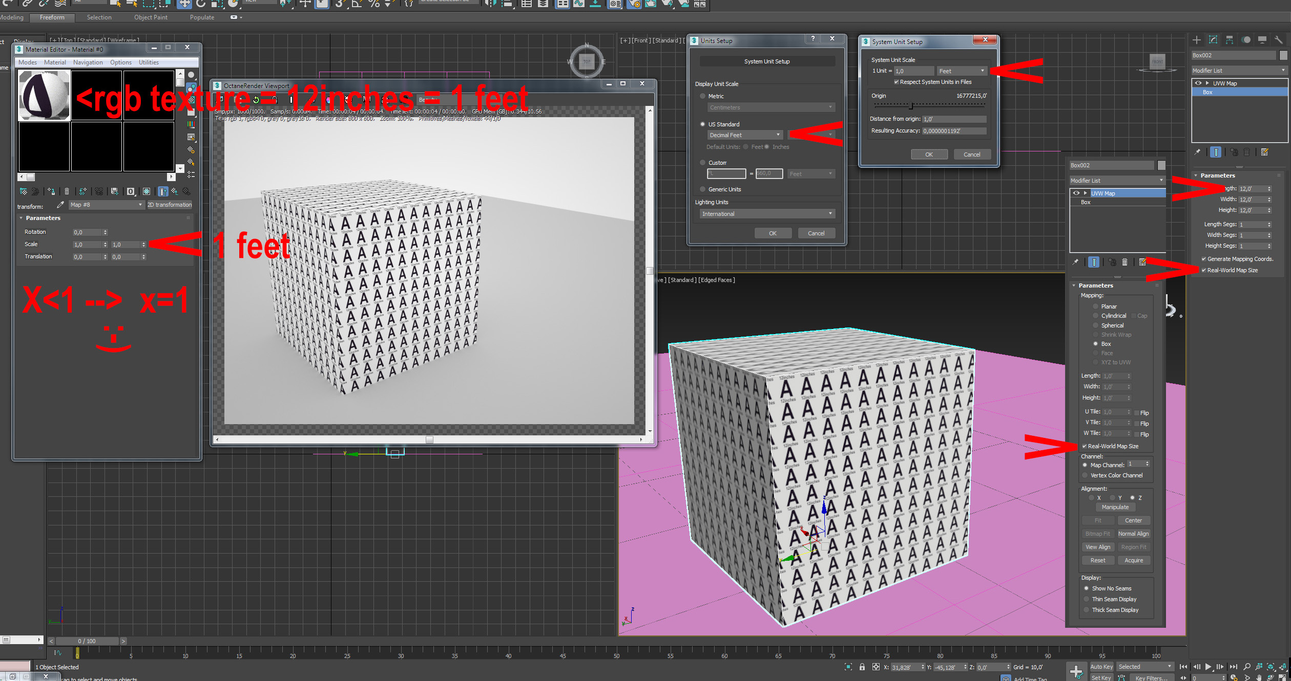

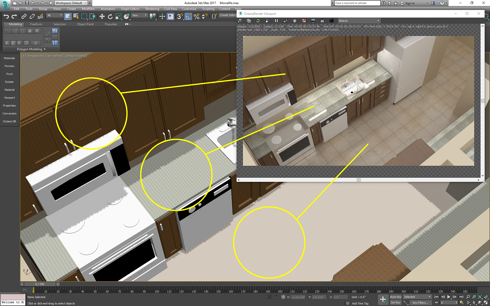

your scene only works because it is not using REAL WORLD MAP SIZE. It is just using a basic 1x1 generic scaling. No architectural renderer can survive on that. Every object has to use proper universal REAL-WORLD MAP SIZE to work across the scene. i cannot go back to non real world map scaling. it would be a nightmare. this use to work in V1, V2 and V3.0
I downloaded you scene and changed the boxes to "USE REAL WORLD MAP SIZE" and then added a "2D transformation" to each material RGB TEXTURE, and set it to 12 and 12 (for a 1ft texture size)
And it all went to crap. See the two images
- richardyarlett
- Posts: 197
- Joined: Thu Apr 09, 2015 8:48 pm
Just to be clear, this is ONLY A PROBLEM with "USE REAL WORLD MAP SIZE" turned on. The problem is with the "2D TRANSFORMATION" under UV transform. The 3dsmax working viewport does not respect changing these values away from 1x1, but the actual OCTANE viewport does. At least that is something, but it makes it difficult to work with the scene in the standard viewport. And it used to work on every version up until 3.0

Hi richardyarlett,
you spoke "USE REAL WORLD MAP SIZE" and I understood now.
You are right, there is an issue about the size and texture.
Here's the problem:
Octane uses a scale of values from 0 to 1 and does not use measurement unit.
the value in 2D transformer works this way too.
So, if you use scaling ratio from 0 to 1 it works properly.
if you uses a scale ratio greater than 1, the issue happens.
I will send the issue to developers to use units instead of scale values.
A work around for now might be to use units in 3ds max greater than all the measures of the texture in the scene.
So you would always values less than 1
for example if you have a 6 inches texture and unit scale Feet (in 3ds max) you will write in 2D trasformation slot 0.5 and it will work fine.
Thanks for your contribution.
Regards
Paride

yeah that doesn't really work as practical. AND it has been working fine since version 1.0. It has only recently been a problem.

ANY UPDATE on this ? This is a major problem for workflow in 3dsmax. There is no way to preview textures correctly in the working max viewport now. I have to keep the OCTANE viewport open all the time just to see my texture mapping.
Where is the official developer comment ? It has always working fine up until 4.20
