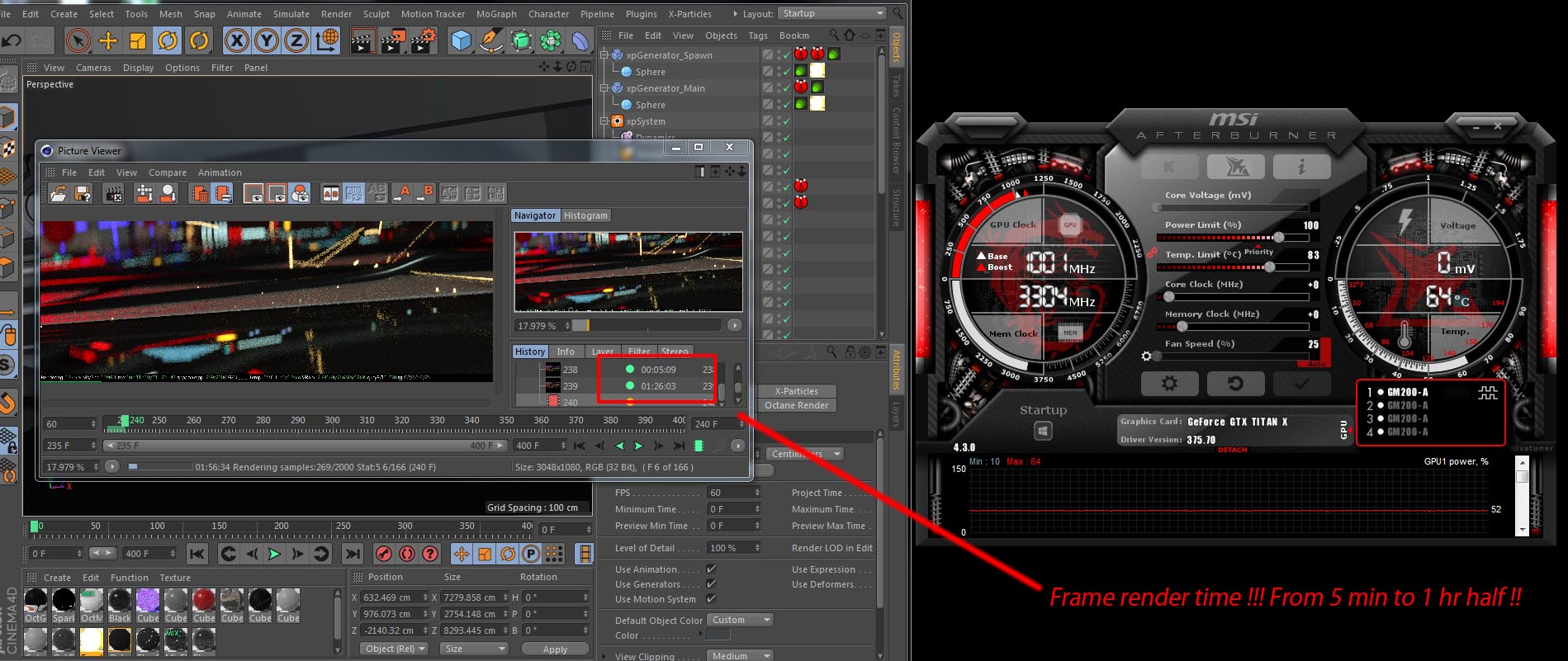

After 15 frames or so, the render goes dead slooow.
All the drivers up to date. The scene is not that complex. Each frame takes around five minutes to render.
Working with 4 titan X
Resolution 4K ( no native )
Help !
Any ideas ?
Cheers.

Send screenshots from MSI Afterburner or any other software controlling your gpus while rendering - please capture temps, core and memory clocks there.

Hi. Thanks for the reply.
Yes. C4D.
It may be a plugin in problem. Funny thing that on testing the render whent smoothly. When ready to final render this issues start happening.
I will ask on C4D section.
Cheers.
Yes. C4D.
Cheers.

Hi there.
At the end, it was a SLI problem. It was activated !
Beware your SLI settings !
Cheers.
