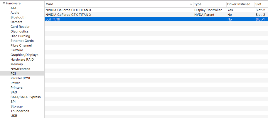

It's not the over heating... it seams the PCIe host board won't even register? this image is the closest I've got it to read... Is there any way to get it to register?
In the image:
the first 2 Nvidia cards are 1 internal card powering 2 monitors.
the pciffff,ffff is the cluster
if I plug the host/connector into a different PCIe slot on my mac it won't show up at all?
It's becoming a headache. Still trying to narrow down the issue.
