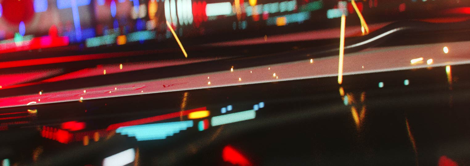

But it took me a while to understand the values to achieve particle motion blur. So, at some point I was thinking that it would be nice to have the option to have the camera motion blur off.
But, it turn out that I need it to adjust better the camera motion blur values.
Still it may be nice though.
Alvaro.

For your example I think what is really needed is a way in Octane to oversample motion-blur per object to simulate retinal persistence,
and yes it would be a nice option to have in this case.
