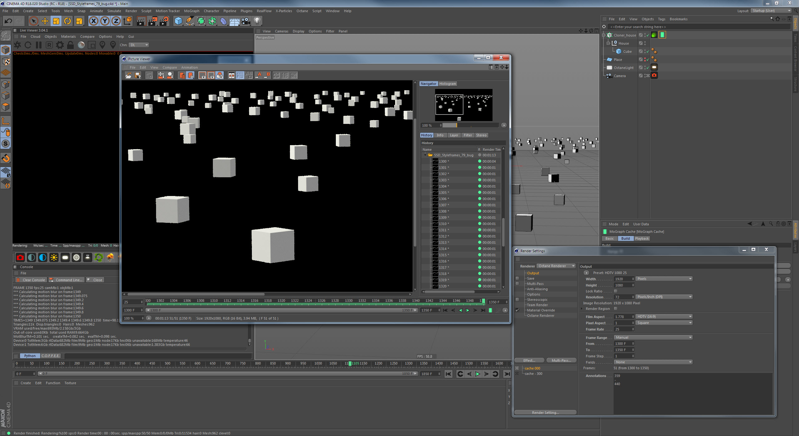

Motion blur stops working at higher frame counts in this case 1100+
All you need to do is render to picture viewer and you should see MB on cubes, then change the render settings to "cache 000" and on the cloners cache tag - change offset to "0", rendering now produces no motion blur in PV (it works in LV)

The problem is the motion blur, if you compare the sequence (rendered as described in first post), one rendered from 1000-1050 and one from 1300-1350, one has motion blur second doesn't.

I missed that because always doing something and overlook sometimes. Sorry. Well it's not working after "time_sampling>4". Don't know why. Propably about evaluation of mg caches from a temporary document.
Thanks, putting it below 5 worked.
