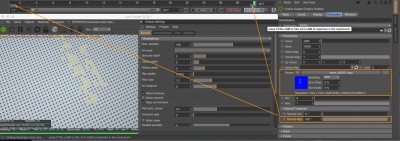

Hi everything,
in this particular case, you have to use the animated texture directly in the Shader slot, not inside an Imagetexture node, and add a couple of key frames, as Ahmet already said:
