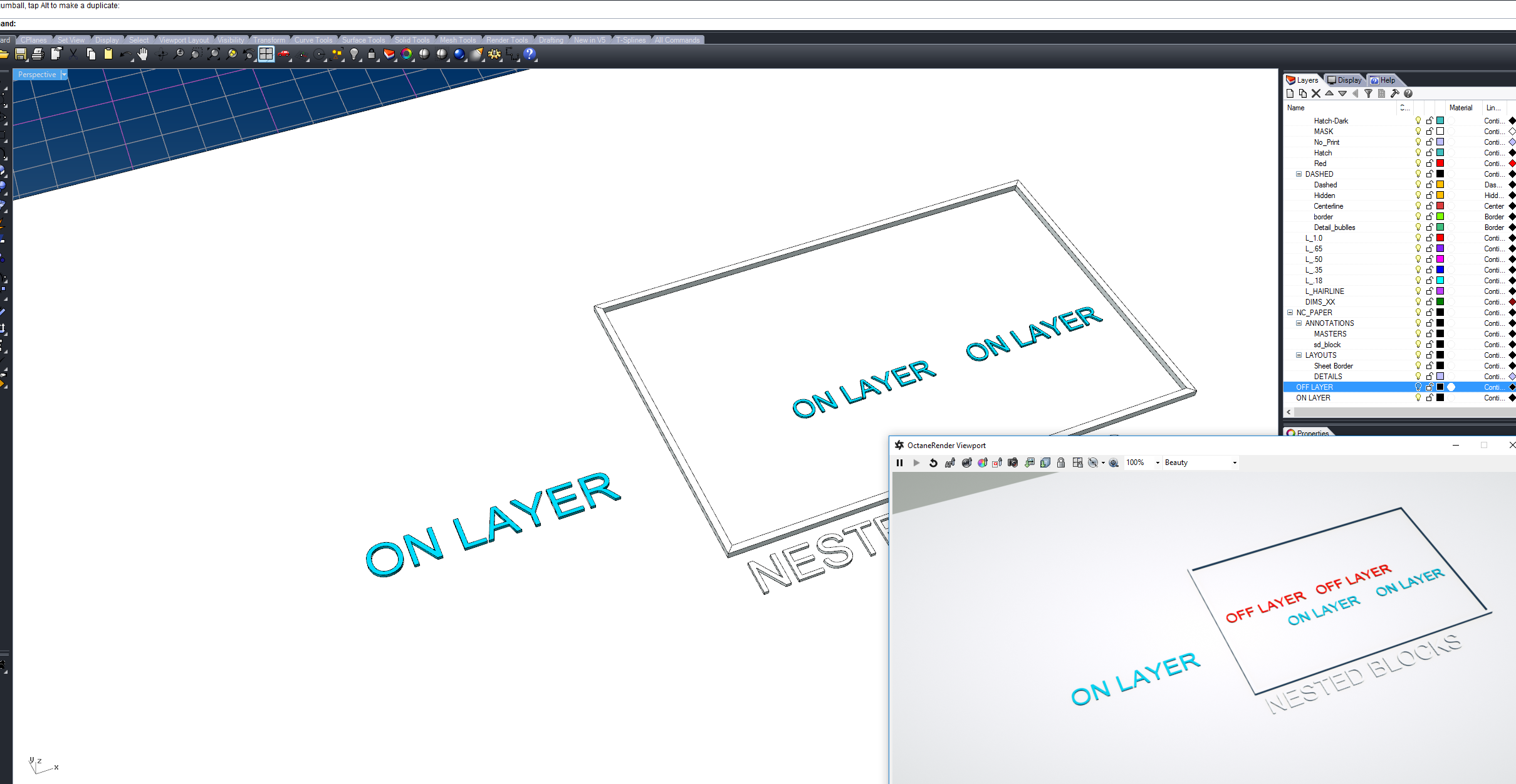

I just noticed an old error seems to have come back. If I have a block instance with multiple objects on different layers, and I turn one layer off, when I render in octane, the off layer objects show up as if the layer is on.
Do you have a sample scene you could send me demonstrating this issue pls? It's not something that has changed for a long time.

Hey Paul,
Here's a file for ya. I realized that the problem is only on blocks within blocks. You can see in the attached file and img.

Thanks for providing the file. This issue will be fixed in the next release.

Below is a test release with the above fix. Can you pls let me know if it resolves your issue.
