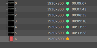

I really don't understand why rendering these frames is getting higher and higher time ! See the capture.
This is only a camera movement, some floatings in the air and a light with various power. Maybe the problem is some where else.. But where ?
Any reasons to explain that ?
Cuda up to date / Octane 3.04.1 / MacPro El capitan Titan X and Amfeltec with 2 980 Ti

Heat. Render first frame 10 time and compare times.
