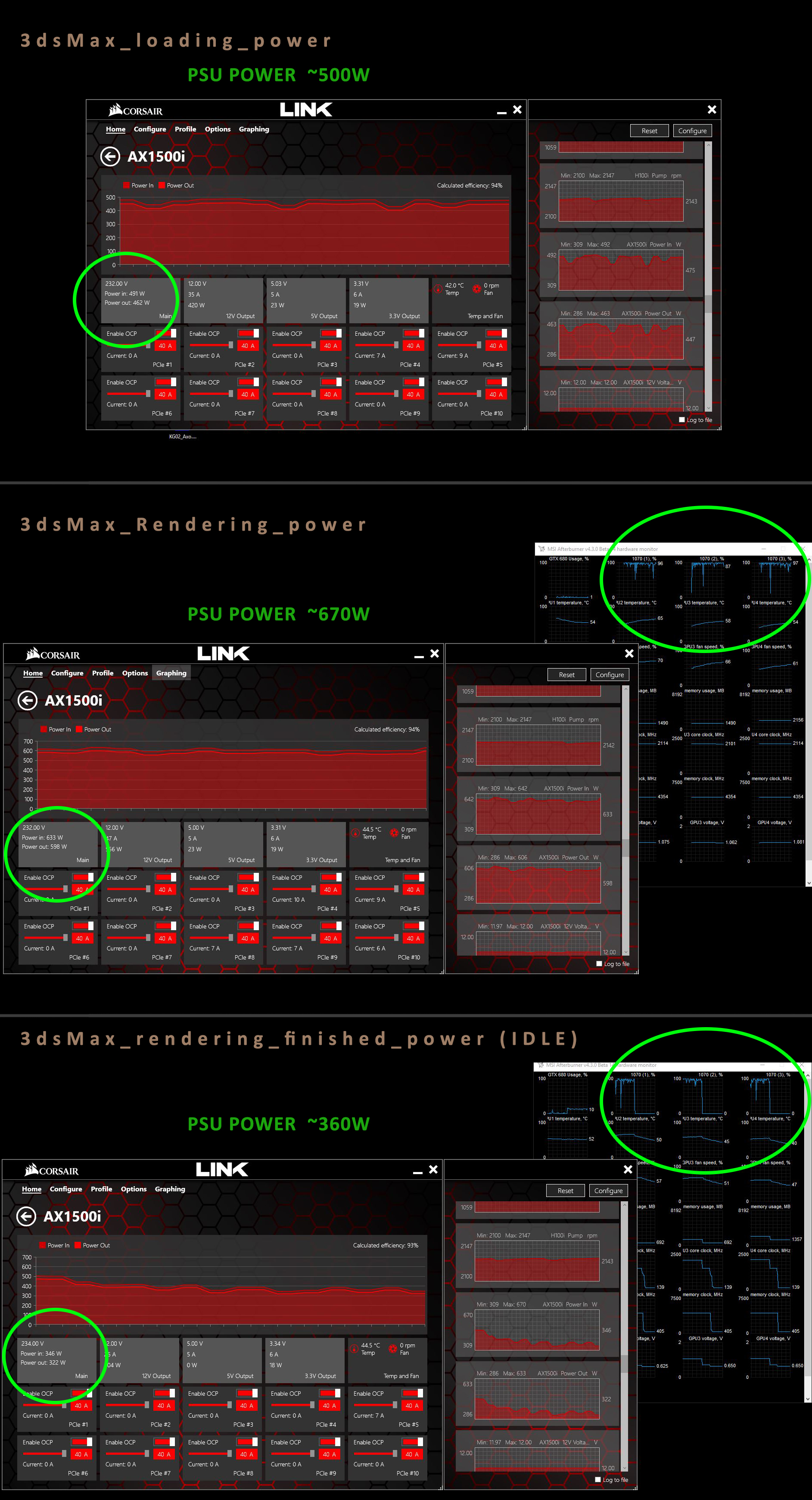

As promised I screengrabbed PSU monitor during GPU render.
I must say the 3x 1070 dedicated to render are Overclocked as well. So I'm trying to draw as much as I can..
The results seems like maximum power draw could be around 800 W whilst all the computer components are drawing power.
Mind you during GPU render CPU doesn't do too much work.
Assume you work on Photoshop or After Effects ( Work on system RAM and CPU ) Along with 3dsmax or any 3d app and doing GPU render on 3x1070.
In this case your power need might be around 800-900 W
But...
The most important thing about this is that you have a very high quality PSU.
The PSU I own AX1500i is supposed to have %94 Efficiency .. Take a look at the image I attach. Reports %94 - %93 efficiency...
As far as I know, Basicly the efficiency value is important because if one component can draw max eg. 180W.
Even you're not using that component, Incapable PSU's might draw that much of power even the component not in use.
If you have a lower quality PSU which it has a lower efficiency. Your system might have problems.
EDIT Just saw your PSU is NZXT HALE90 850w. it seems to be up to %90 efficient.
Bottom line so it looks like it might work. But I cant be sure.
There is another fact that in terms of power. There is a problem with random power spikes. But quality PSU can handle an amount of power spikes with no problem
Take a look at the image I attached...
But...

Wow that's some great data, thanks for such a fast & quality response.
I know my system would pushing it's absolute limits in regards to 3x gpu setup. Not only in power but also PCIe lanes. I think to be safe it would be best to get at least a 1kw PSU before adding an extra GPU. I would rather spend an extra 300-400ish on a PSU than risk damaging the entire rig. Like you brought up 850w @ 90% eff is just to much on the bubble for my taste.
