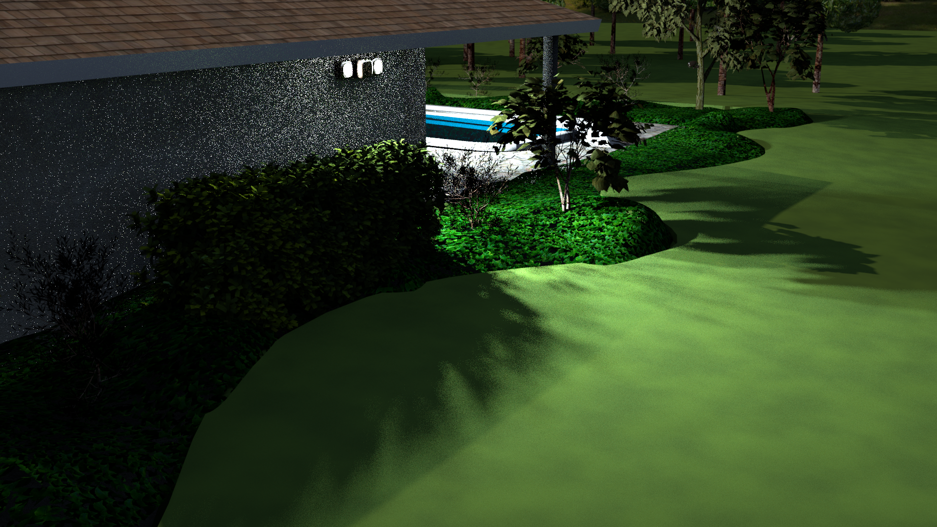

I'm trying to do a light study and the scene looks aweful. I've bumped the samples up to 5000 and it still looks bad. There's got to be a way to make this work.

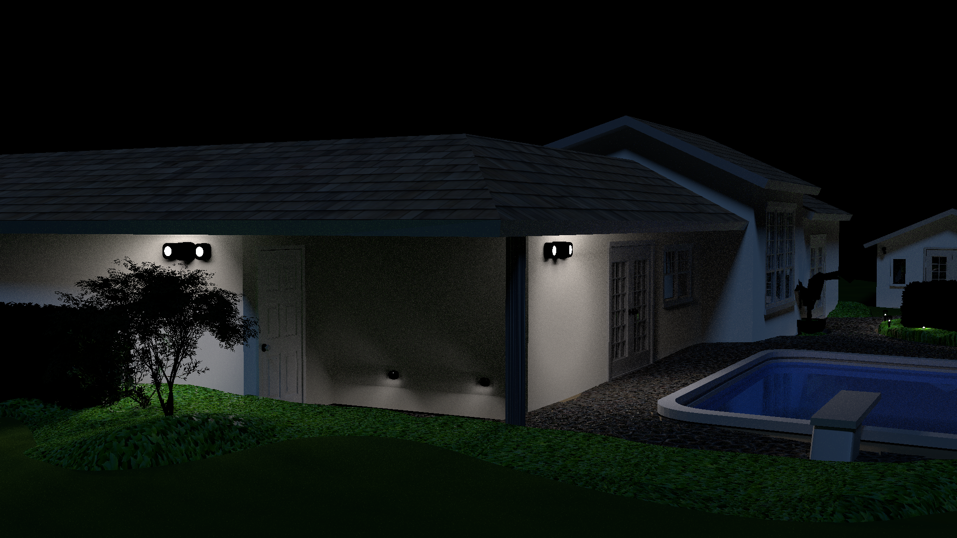

Thanks, I tried all of them PMC, Path Trace, Direct Light, all different settings and hotpixel removal cranked up. The best solution I've found so far is "Cycles".
This was done with 500 samples. Pain in the butt reassigning the materials.

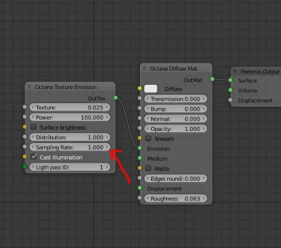

Do you have a scene you could share, as I'm having a difficult time even building a scene with these issues. Here is where the importance sampling is:

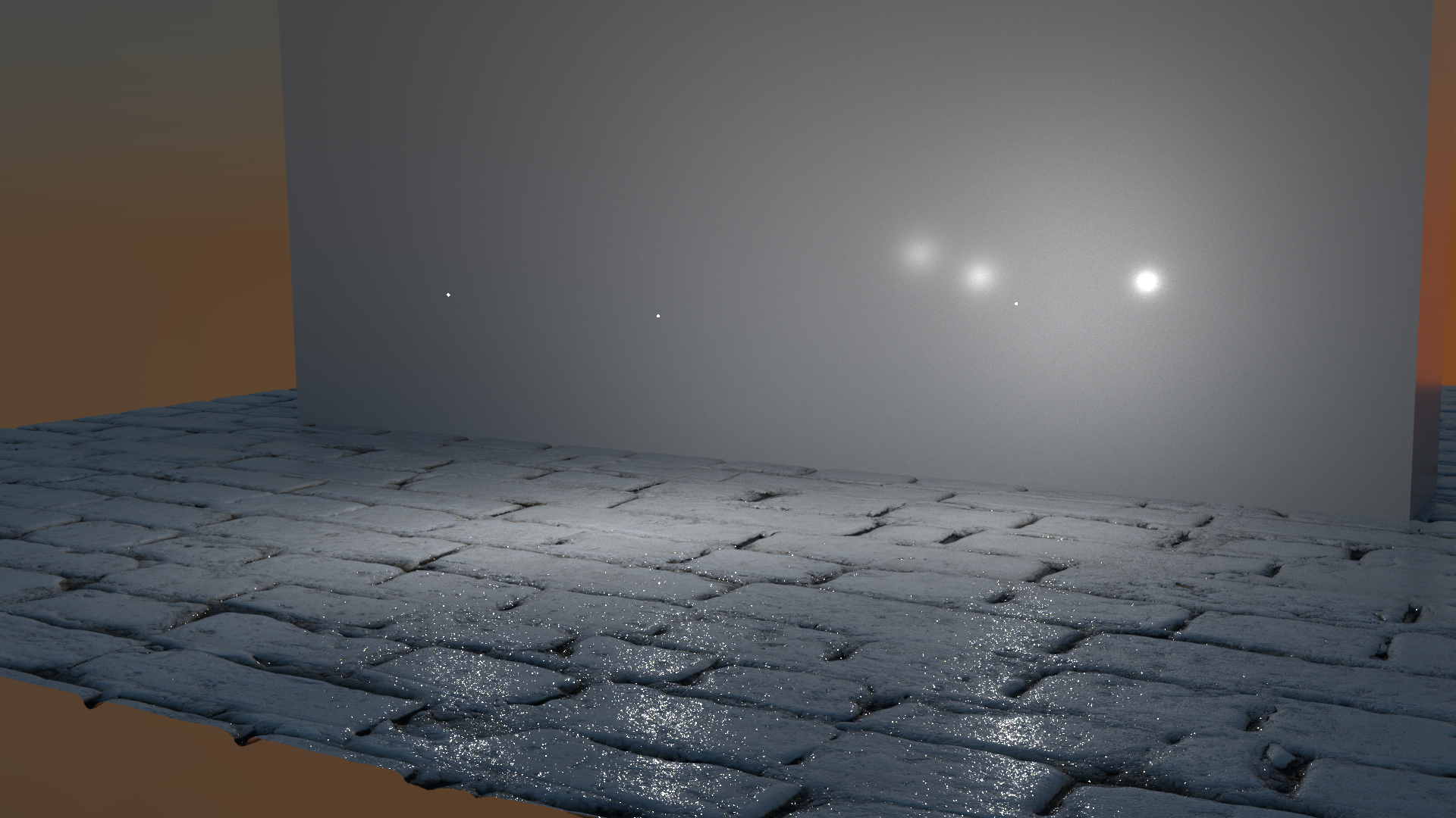

Here is a simple scene I attempted to get a lot of fireflies. I have three very small light sources and the environment has been set to low light.

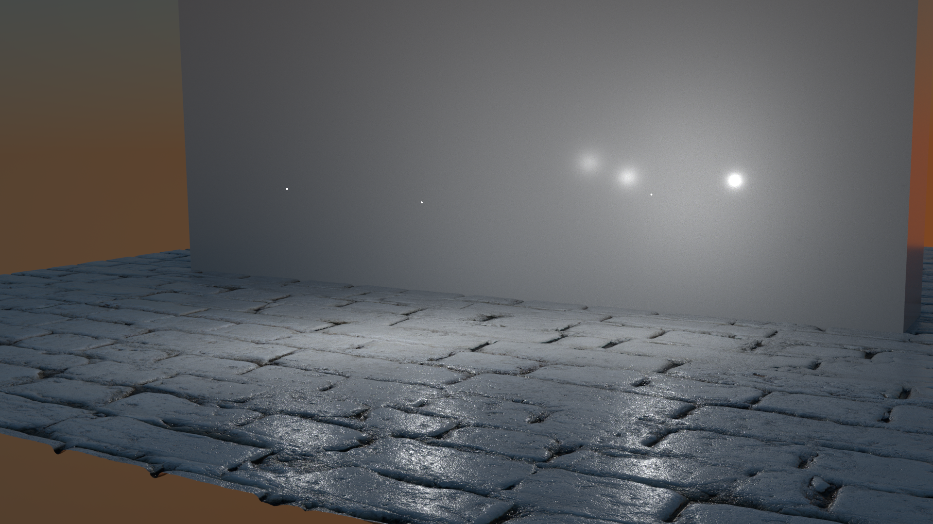

The interesting thing about this is that I had to set the roughness really low, in this case it's set to 0.01. But when I up it slightly to 0.1 the fireflies go away:
Glossy is set to 1.0 for both, so if you have an example .blend file I would be very interested to try and solve this.
The attachment firefly2.png is no longer available
