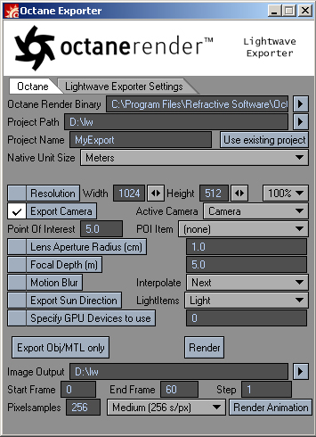

Comes with two .obj exporters - you can switch between the two inside the Octane Exporter GUI.
  • "Lightwave HC OBJ Exporter" is Lightwave Layout internal obj writer only available in Lightwave HC (build 2013 or later)
  • "Octane OBJ Export" is written by me and windows only. For Lightwave 9 or later.
Please check the readme inside for more details and differences between the two.
!Please make sure you read both the offical manual on Plugin<->Octane workflow and the readme.txt inside this package before using this plugin.
If you have any issues please give me information what your export settings are and what you're exporting. You can reach me on skype 'walfridson' or at my mail if you want faster contact or sending me files.
If you have any requests let me know!

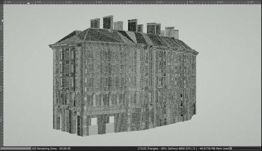

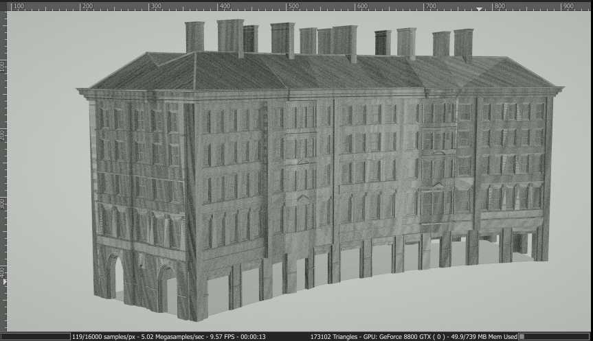

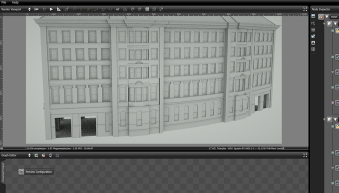

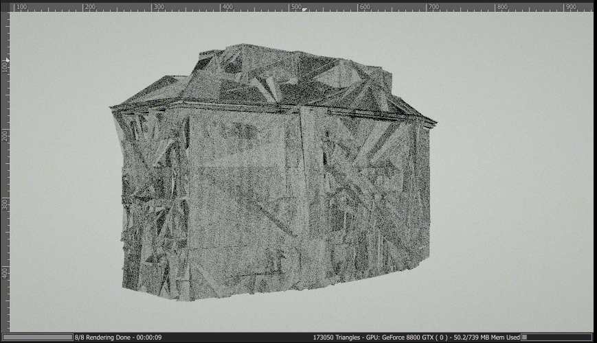

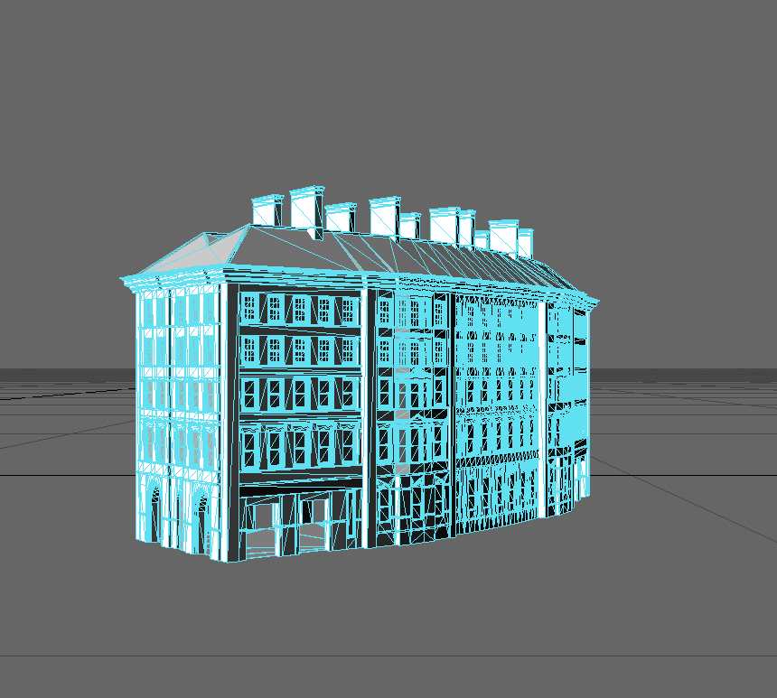

Here is some problems I have noticed :
- I'm trying to export an object :
~170 000 polygons.
only 3 points poly.
- Exported from lw9.6 in normal mode. time : 2:55 min
- Exported from lw9.6 in fast mode. Time : 0:42 min
- Exported from modo Time : 0:15 min
I have Tryied with HC with lightwave obj exporter otion but it make an error in octane...
I hope I can do this project in lightwave because I don't like to use modo's camera. And because this is a animation, I can't wait 2:55 to export each frame.
I don't know if my mesh is not good or why octane makes the error in mesh?

holocube
Posts: 73
Joined: Sat May 29, 2010 8:45 am
Location: London
Model was huge, 5km wide. obj seems to be written fine but not sure why it looks funky. Will test some more
I scaled it down to meters (and exported as meters)
