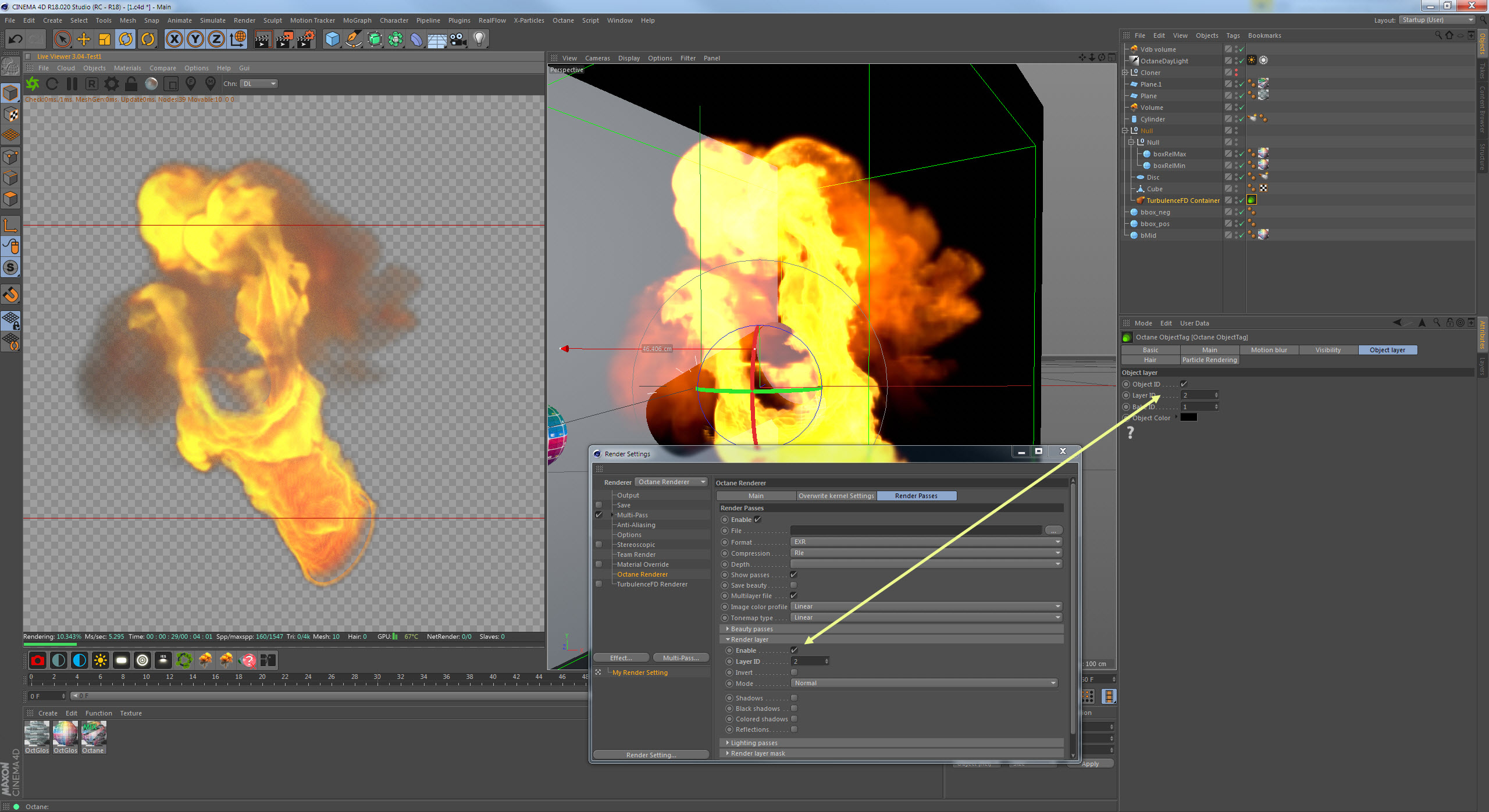

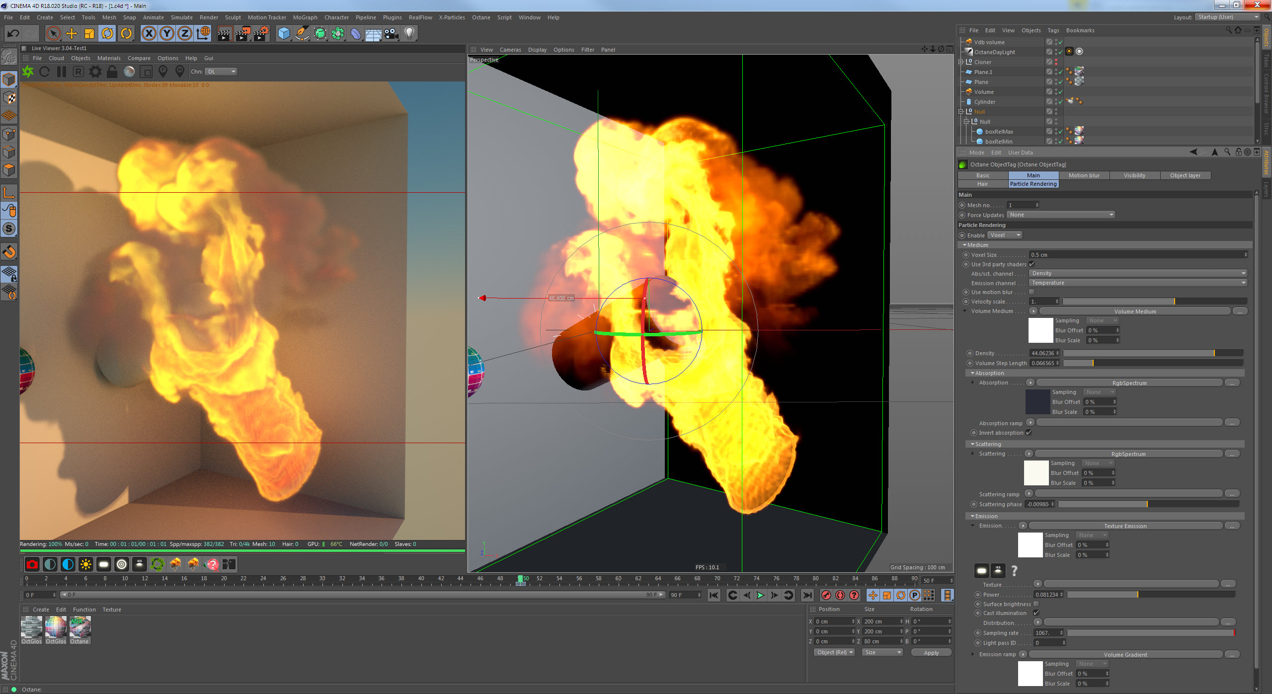

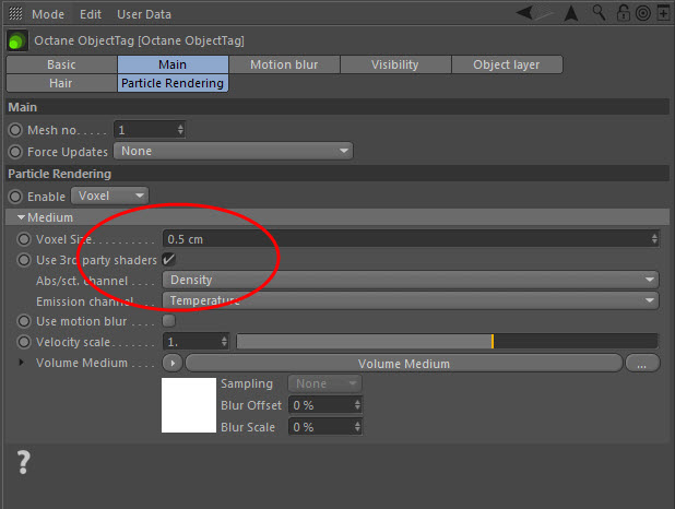

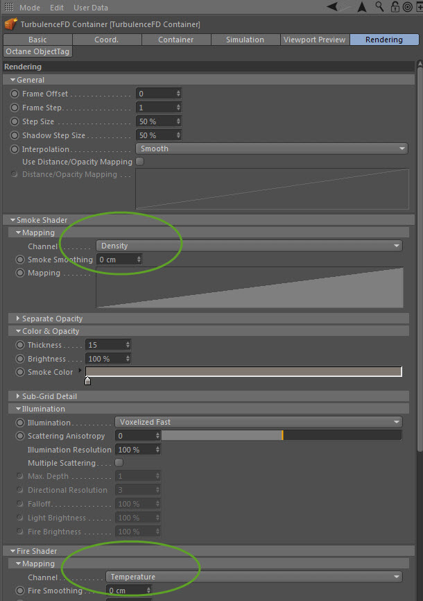

If you mean shader applied results YES!
But it requires a bit complicated setup. Requires some good balance on parameters. I attached a few images to show this.
Also on next build we'll support objectIDs for volumes as you can see on another images.
