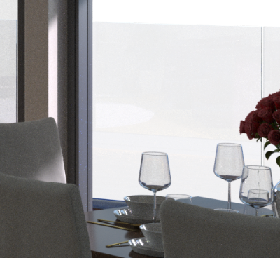

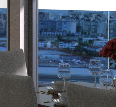

Hello,

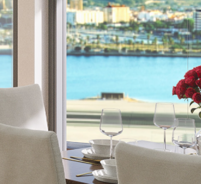

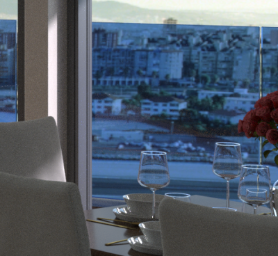

I'm having an issue with coloured glass. When I save the image with the alpha channel enabled, the glass has no colour. When I save it with alpha chanel disabled, the colour is there. The problem is that I don't want the HDRI included as I want to place a background image separately in Photoshop.
I've added some crops to explain what I mean. As you can see, the image with alpha channel diabled shows the blue glass as it should be but the one with alpha channel enabled shows it without any colour.
I'm using absorbtion medium to get the colour but I've tried it with transmission and it has the same result. I'm using the Pathtracing kernel and I have fake shadows enabled. Switching off fake shadows has no effect. I've also tried a separate HDRI for the background set to Visibility Environment but with no success.
Does anybody have any suggestions?
Thanks,
Rico

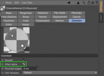

enable the Affect alpha option in the Common tab of your specular material: ciao beppe
Thanks Beppe,bepeg4d wrote: enable the Affect alpha option in the Common tab of your specular material
But I should have mentioned that the first three images in my initial post were with Affect Alpha enabled. The problem is that the colour of the glass isn't there when the alpha channel is applied.

To be more specific: It is not possible to compose colour filters using normal alpha compositing. You would need an alpha channel for each colour channel (i.e. 3 alpha channels) and if the result is saved with pre-multiplied alpha, it's possible to achieve what you want to do. As far as I know, none of the compositing tools allow something like that. Please correct me if I'm wrong here.mojave wrote:We are aware of this and it is in our todo list, at the moment this is a limitation, so the background should be rendered as an environment node.

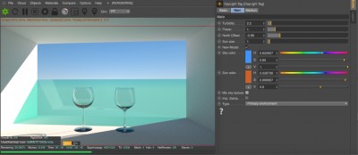

I have made some experiment about this issue and I think to have found a different solution that doesn't involve compositing.

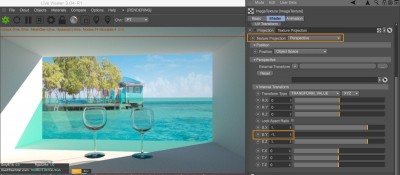

The idea is to use the Visible environment for placing any kind of image as backgrond and use it aslo for refraction reflection.
Here is an example scene: The Primary environment is the Physical sun (but can be also an HDRI): the Visible environment is a Texture environment with a generic 8bit image file: The projection is changed from Spherical to Prospective with negative Y axis: All the Visible environment option are active so the background is also visible in refraction and reflection.
