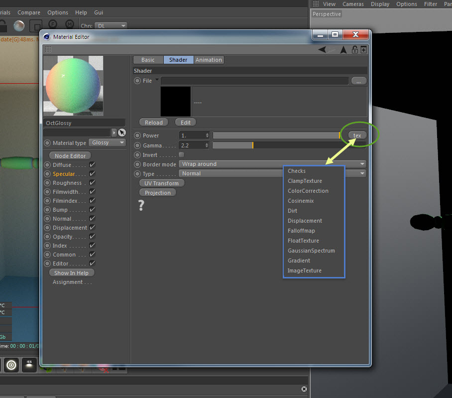

Posts: 16067
Location: Türkiye
As i said i couldn't find a way to customise menus. Only idea is like that in attached picture. Bring a custom menu with a "tex" button.
