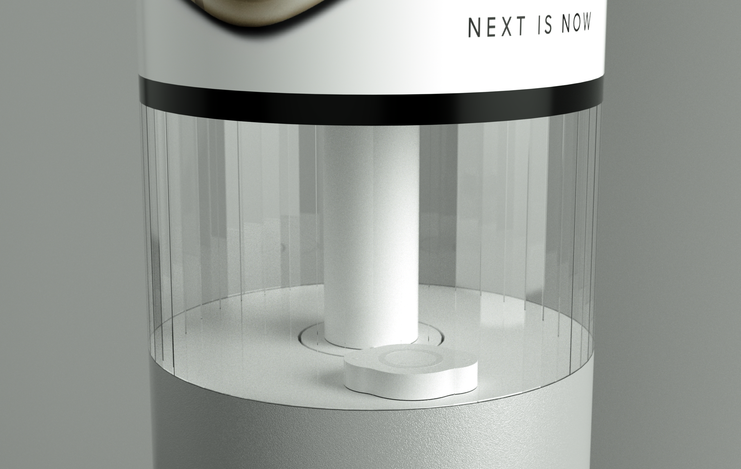

When creating transparent tubes in Rhino, I can see that Octane does not make a perfect curve, but small sections... and my render... sucks :) See the attached image as an example.
How to fix this?

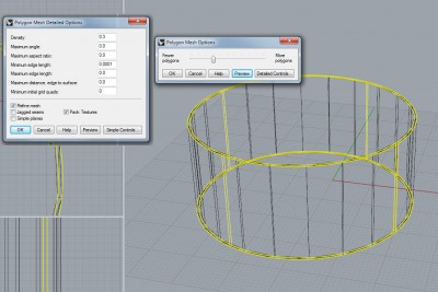

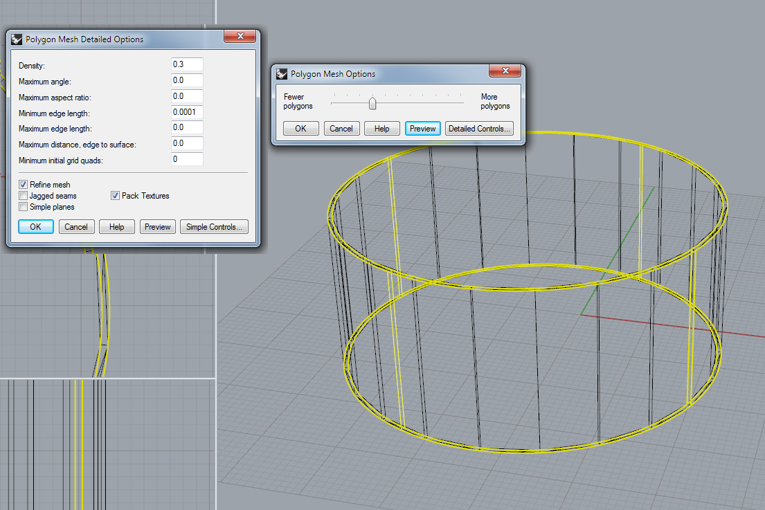

Did you try to adjust its polygonal quality through polygon mesh detail?
Rhinoceros before using octane for rendering, transforms NURBS, solid etc in polygonal surfaces.
Through polygon mesh detail, you adjust the quality of each part of model when you go to render.
Mesh> From NURBS Object>
Let me know your news.
