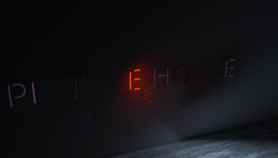

Hey guys,
I'm having a few problems with lighting a neon sign on Octane. I've got this scene and I keep getting really bad light leaks and fireflies everywhere. I'm using Direct Lighting and that seems to give me the best result. I've used a texture emission on the neon tubing to give the look but I dunno... maybe I'm missing something? Any help would be amazing.
Thanks.
Windows 10 / 16GB Ram / GTX 980 Ti SLI / Cinema 4D R16
Terryvfx
Posts: 385
Joined: Tue Dec 30, 2014 12:43 am
Use PT and lower the GI clamp until you see an improvement, do you happens to have any texture in the emission slot of the material? also this is not real but turn of "shadow visibility" for the specular letters so they don't cast any shadows (this could be a big help)
adeelk93
Posts: 21
Joined: Sat Oct 03, 2015 12:14 pm
Terryvfx wrote:Use PT and lower the GI clamp until you see an improvement, do you happens to have any texture in the emission slot of the material? also this is not real but turn of "shadow visibility" for the specular letters so they don't cast any shadows (this could be a big help)
Hey dude, thanks for the help. I've got an RGB Spectrum in the emission slot of the material, just to give it the colour I need. I'll definitely have a look at this. I'll repost when it's done.

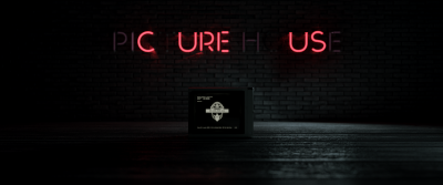

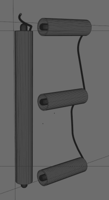

DUDE! this scene is crazy I now see why Octane was giving you crazy stuff.
The neon tubes, they need to be properly modeled! you have intercepting geometry and more importantly the glass it's just one piece you need to have some thickness, going for cylinders it's a much better alternative. In the sweep for the neons you need to check "create single object" too, Octane was giving the material to three models instead of one and that means triple the number of lights in every instance.
I tweak the splines and added a bevel deformer here to get the same effect as a cilinder but then again cilinders are much better option (they are simpler to use!)
I only needed 1024 samples to get this clean without artifacts
