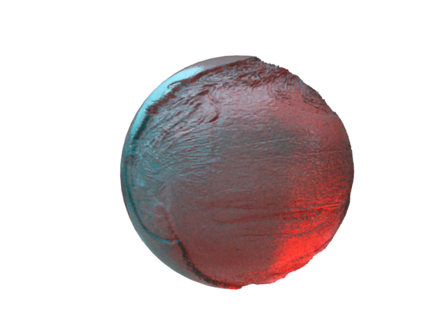

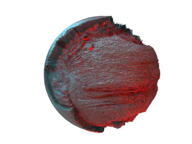

tschwenke
Posts: 338
Joined: Sat Sep 20, 2014 9:35 pm
Location: Germany
As far as I know, just click the Displacement layer and adjust the height.
Best wishes,
Thomas
http://www.thomas-schwenke.me
Houdini 20.5 || Win11 || i7 + RTX3080

tschwenke
Posts: 338
Location: Germany
No, works well here. See images. What version are u using?
Feel free to send a CAR file for testing.
Best wishes,
Thomas
