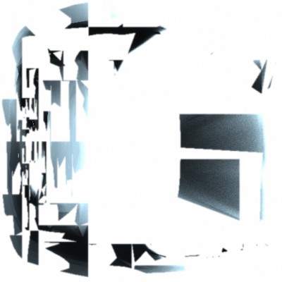

@ juanjgon, thanks for looking in to this. Your results is very different from mine. Here is my result from the scene I uploaded.
The info kernel with wireframe backface did not reveal any errors. I increased the kernal epsilon form 100 nm to 1 mm to 100 mm with no difference.
Thanks.
@ MojaveBaking camera
Moderator: juanjgon
The same scene. I've just loaded it and press IPR. It is true that I'm working with a new API build. Let me check the released plugin build.Alteris3D wrote:juanjgon, now I'm confused. Did you change anything besides removing the shaders? Our results are very different. Could it be a GPU issue?
-Juanjo
Yes, Octane 3.03.2, LW 2015.3 (win64). However, in the about Octane panel, it shows up as LW2015.2juanjgon wrote:Weird. What version of the plugin are you using? It seems the 3.03.2, but it is only to be sure. Are you working with LW 2015.3?
Thanks,
-Juanjo
My video card is kind of ancient, Quadro 4000, but the drivers are up to date.
Yes, you are right. In your plugin version there is a problem with the baking feature and this scene.
It should be fixed now. Please update your plugin to the latest build available 3.03.4.1
