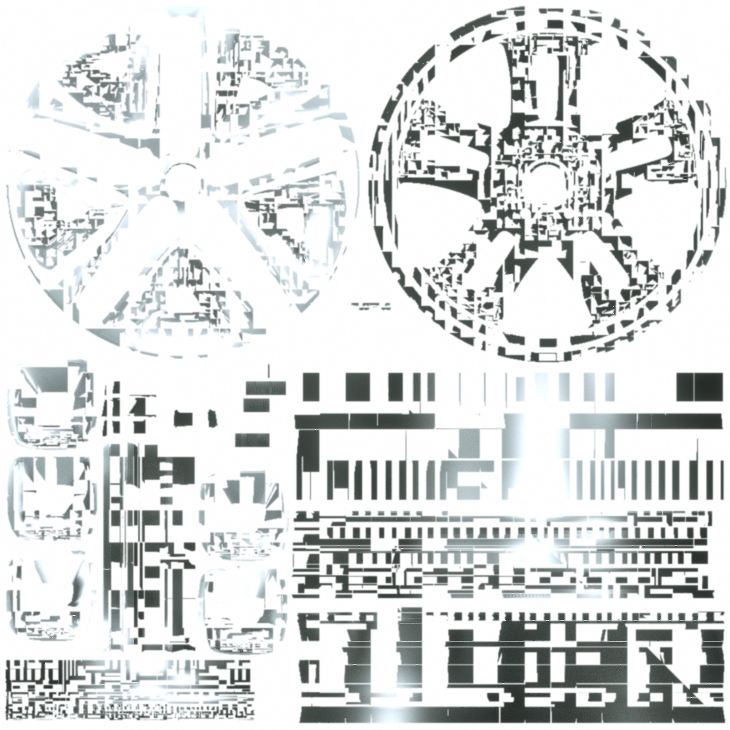

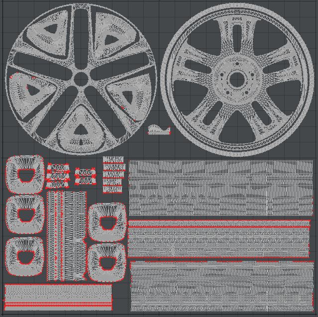

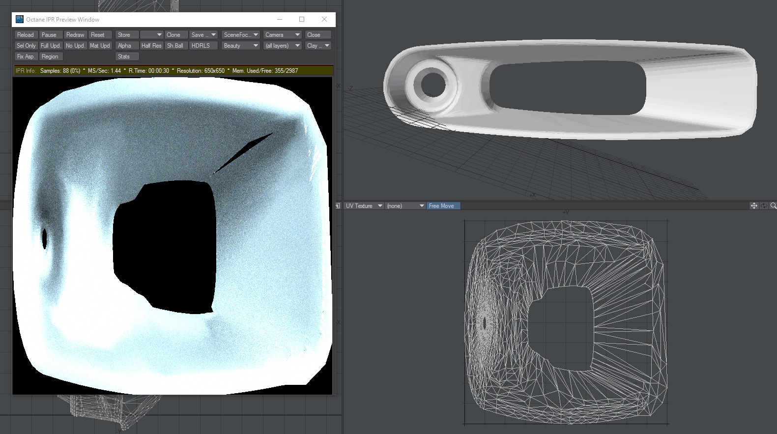

I'm getting some strange results from the baking camera. The LW baking camera is working as expected, but the octane baking camera is giving me a strange pixelated result.
This is my UV map from modeler

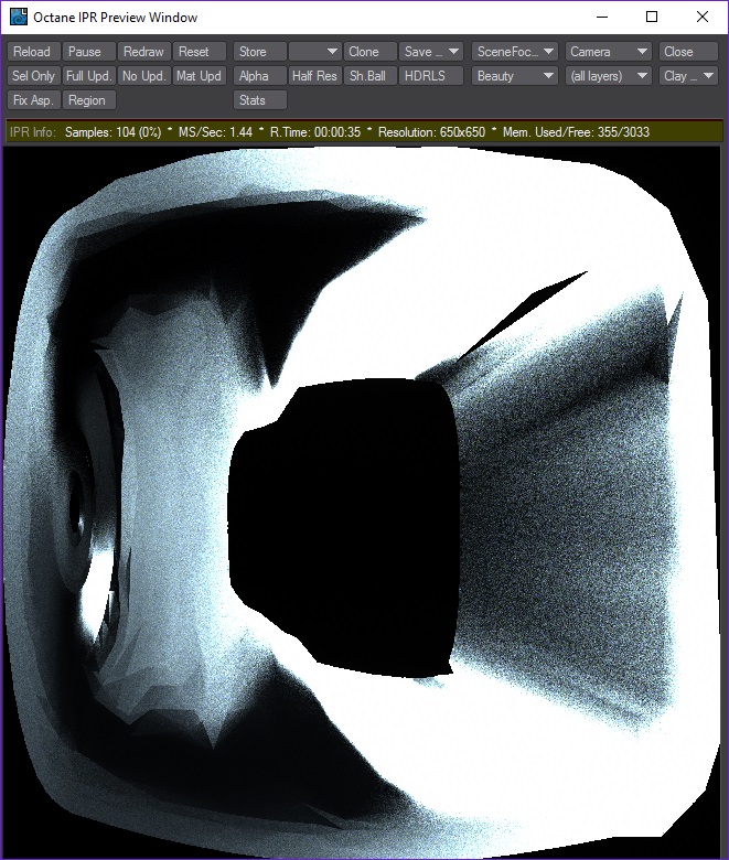

Octane render
Thanks in advance for any help or suggestions.
Make certain the following conditions apply to your UV map:
- No overlapping uvs. Octane cannot currently do proper baking if multiple polygons occupy the same space. This means "mirrored" uv maps are no good for baking.
- Every polygon in the entire object must be assigned somewhere in the UV map, even if parts of the model do not need baking.

Yes, I've checked the model and the map and there are no overlapping polys and no ploys that are not part of the map.

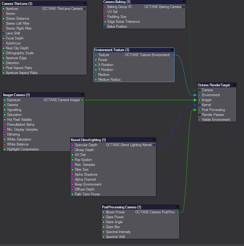

I can't post the scene to the forum as the data is from a proprietary CAD file. However the setup is fairly simple. No displacements, I have a glossy material and a diffuse material mixed for the wheel surface. The render target screen grab is attached. Nothing but the basics really, I've only been using Octane a couple of weeks now.
I created the UV map for the wheel by cutting out the inside areas of the spokes, creating object morphs for them and flattening them out, manually dragging points here and there to keep geometry from overlapping then making planer UV's for everything besides the outer and inner edges of the wheel, where I used cylindrical mapping. Then I put everything back together and merged the points. All triangles.

There's not much I can get from that capture, however you may try a couple of things:
- Render the wireframe view using the info kernel and enable wireframe backface highlighting. If the model's normals would be flipped that could cause this and you should see some red faces in your render.
- Increase your kernel epsilon and let me know if you get anything different.
If none of these work, it would be great if you could share just a small part of your scene with which this can be reproduced.
