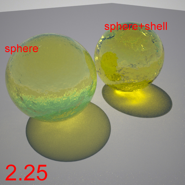

Elvissuperstar007
Posts: 2545
Location: Ukraine
caustic not work
if you add thickness

paride4331
Posts: 3878
Hi Goldisart and Elvissuperstar007,
about caustics:
There are some known parameters using Octane Render that should not be forgotten.
If you want to have caustic and do not want to have artifacts, the right engine is PMC.
If you want to see caustic effects in your render some correct settings could be:
Caustic Blur: 0.015> 0.030
Gi clamp: at least 10000
parallel samples: 1
The effect of caustic in physics are determined by various well precise factors that generate a more or less pronounced effect.
Reproduce this phenomenon using inappropriate values does not always lead to the desired results.
I am attaching a test scene in octane Octane 2 and 3 produce same response.
It is very useful to report software issue, but much more useful to permit developers to concentrate on real and concrete issues to resolve.
It would be very helpful if before invoking a bug, users did the shrewd tests according to the right knowledge of the software.
Regards
Paride
scene-sample.zip
(258.65 KiB) Downloaded 291 times

Goldisart
Posts: 780
Joined: Sat Oct 26, 2013 8:47 am
paride4331 --- !!!!!!---- Yes you are right --- ------ The question is - physically correct and right ? all glass to put FACKE SHADOW ///// because for instance if the glass to position the light source then I believe it is wrong.... - please explain
paride4331
Posts: 3878
Hi Goldistart,
You reported a "bug" in the version 4.19
I showed you there is no difference between Octane2.25 and Octane4.19
I used fake shadow only to quickly calculate the scenes to show the same result.
Here uploaded the two scenes without fake shadow.
The concept does not change.
correct settings, satisfactory results.
a bug is another thing.
Regards
Paride.
