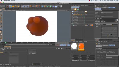

HiI try to reproduce this tuto with a vertex map in luminescence channel of a c4d .
How can I do it with an octane material?
https://vimeo.com/184392563
Thnanks

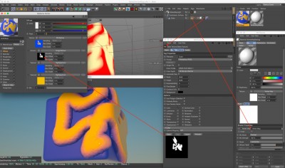

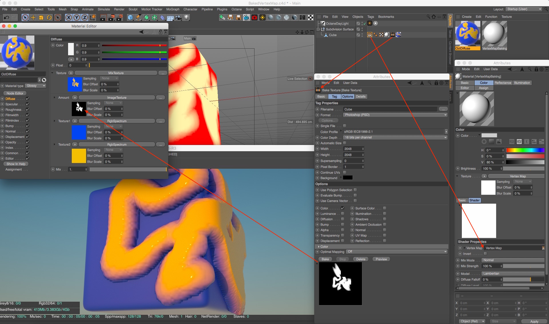

Posts: 10597
But you can convert vertex map into bw texture and use it in any octane material node, look at this fast example:
