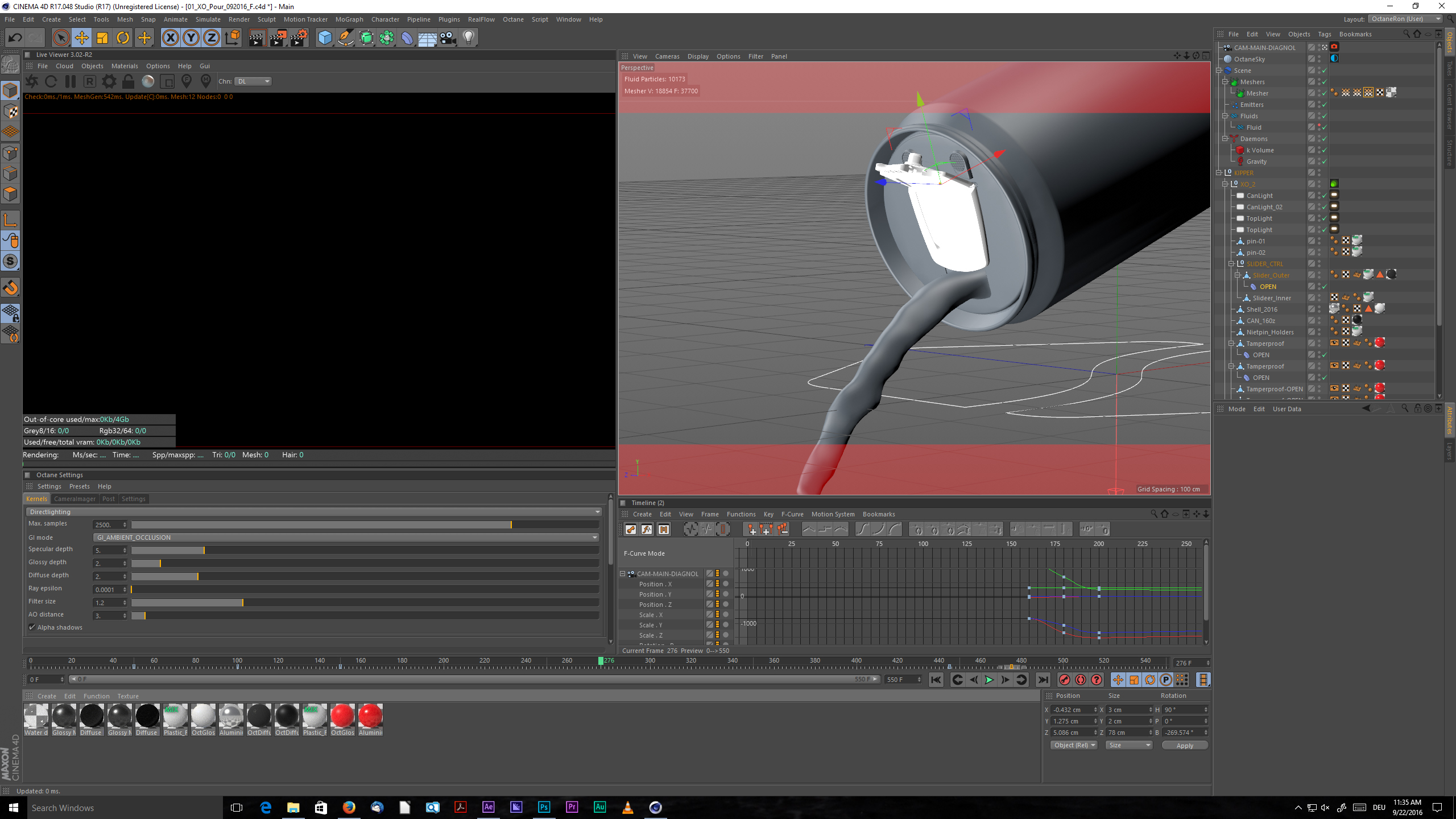

I also cannot screenshot the problem, because as soon as I send this particular file to the live viewer window to render then Cinema freezes and there is no reaction at all.

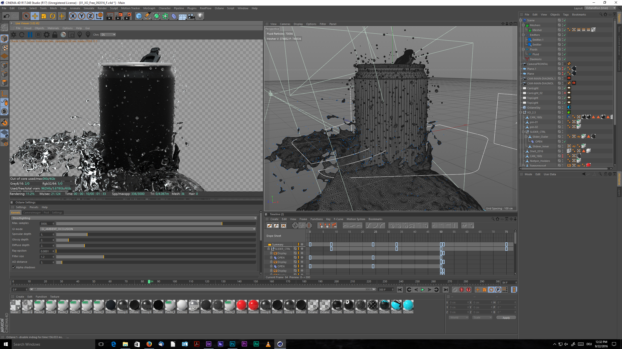

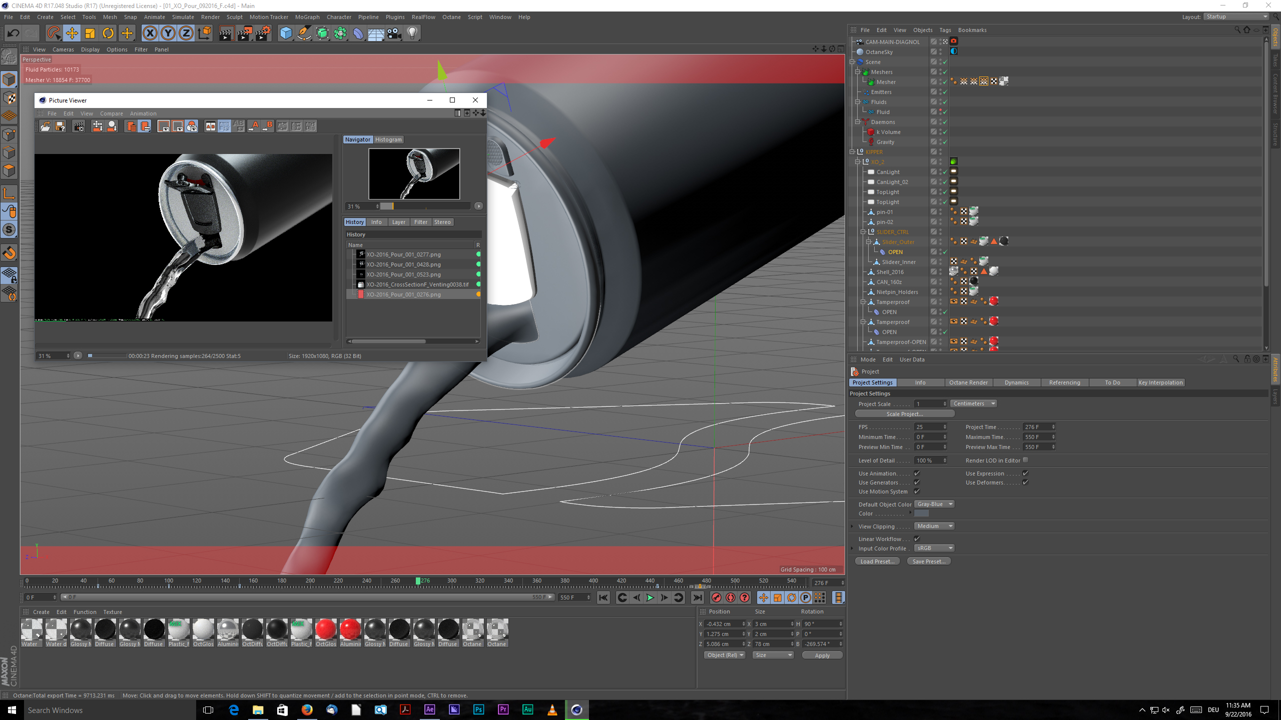

Attached are screenshots, Picture Renders without problem. Live Viewewr never gets the chance. Hangs at the command "copying active document"
Using real Flow Plugin for Cinema 4D with Octane shaders from the LiveDB.
Any Ideas?
