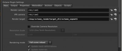

This scene has an object with a non constant mesh topology among the frames, so it can't be rendered in update mode. Please, change the rendering mode to "Full Scene Reload" in the ROP node to render the sequence.
