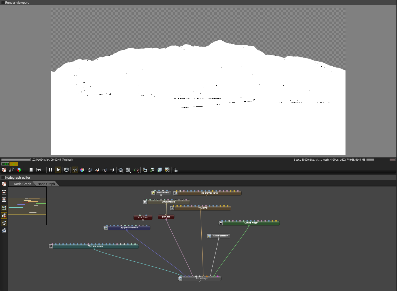

Hello all, I have read other posts on the forums, but I can't seem to find an answer relative to my issue.
I am using the stand alone software, no plugins.
I can't get the zdepth to look right.
I attached an image of what I mean.
But here is a description of it.
It's essentially all white. There is very little black or grey, and it doesn't look like a normal zdepth pass. I have tried all sorts of different combinations in the infopass kernel and even the export options. But it comes out the same regardless of what I try.
Is there something I am missing? I read the manual, but it doesn't offer much in terms of set up and "how-to".

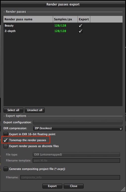

the Z-depth max value in the kernel settings or in the info render passes works in meters, depending on your geometry dimensions, use a proper value. When exporting, remember to active the tonemapping option for visualizing different shades of grey in the Z-depth pas.

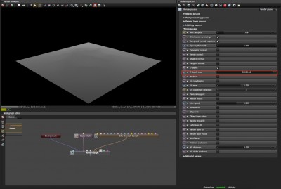

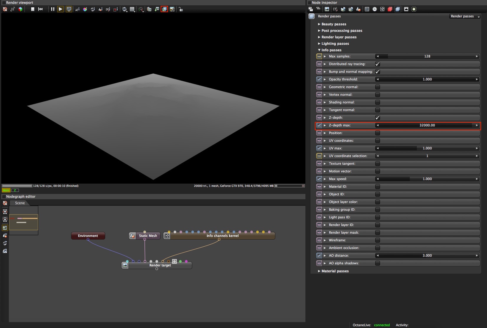

Hi artech7,
here is a 8km x 8km terrain with Z-depth at 32k:
8KM-or.orbx.zip
(510.09 KiB) Downloaded 181 times
use the Save render passes button in the Viewport to export the final image with the "Tonemap the render passes" option active:
ciao beppe

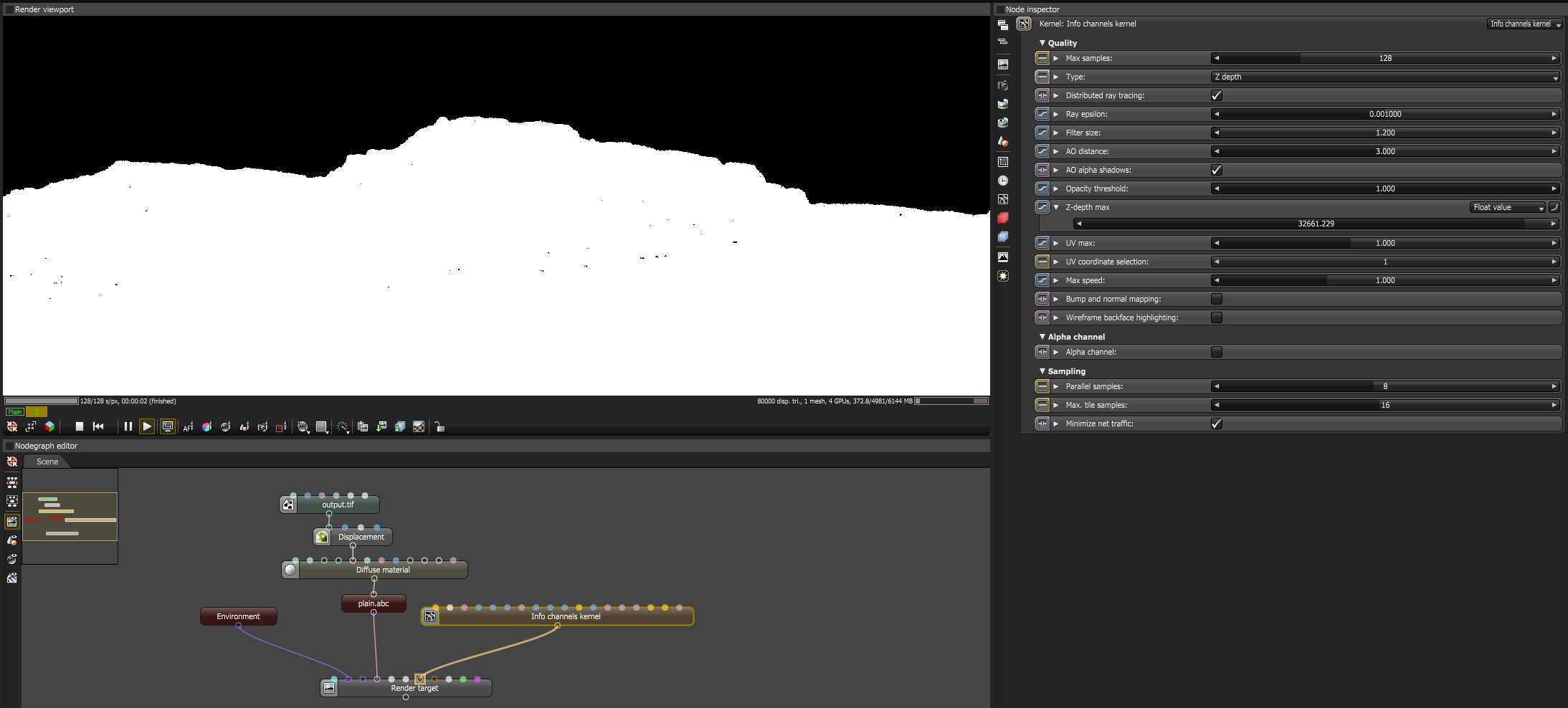

So, I took the scene you shared and just added the plane object and displaced it with a heightmap.
So nothing has changed except for the mesh object.
Here is the setup.
Same outcome.
