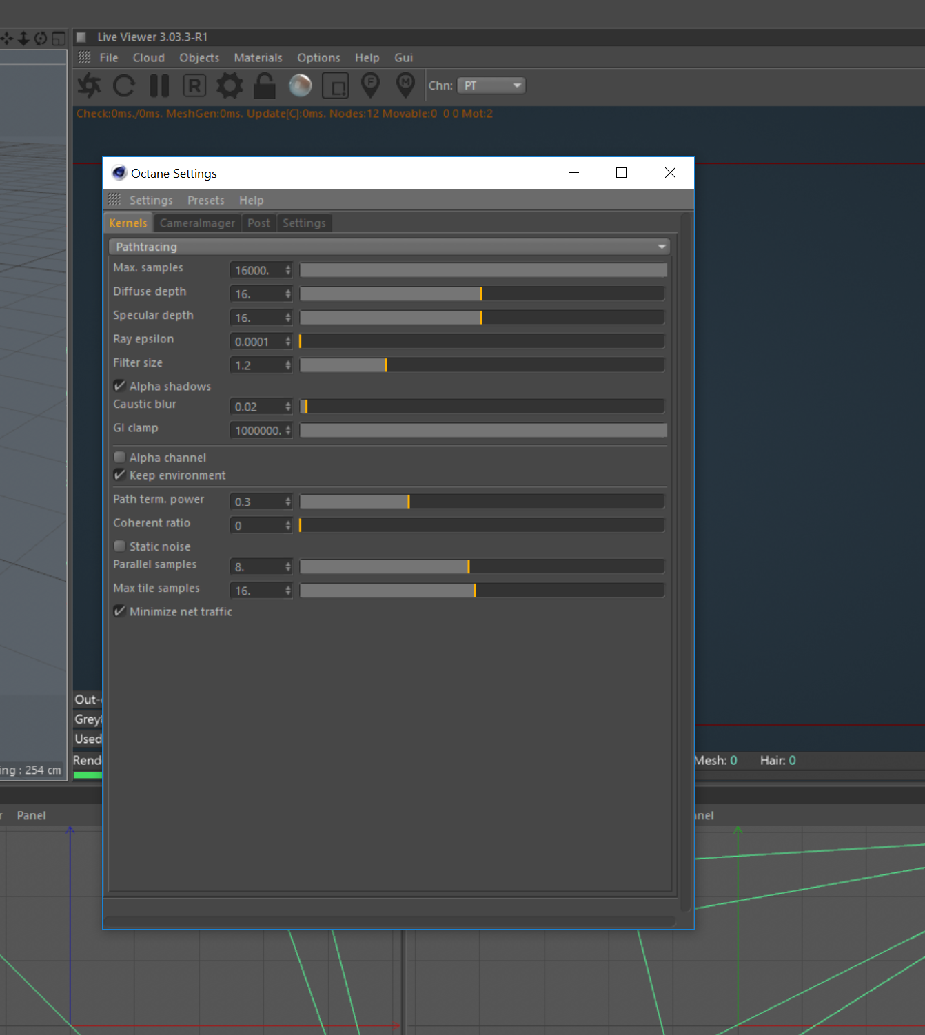

The Volume Step Count setting seems to be missing from octane settings in cinema 4d. I am trying to follow along with a couple tutorials to use turbulence fd and the tutorials all point to a setting here which I don't have. Has it moved or something? Thanks in advance.
Missing Volume Step Count option
I believe Volume Step Count is the same as Volume Step Length, which can be found under the volume medium.
Set Voxel size to your tfd voxel size (or sometimes a bit less, helps in some cases) and tune your step count accordingly.
