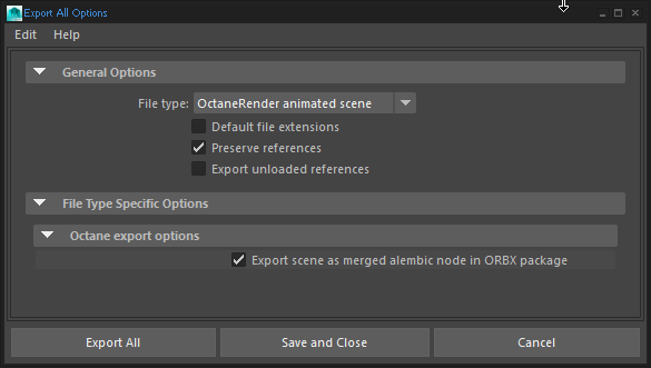

If you export your scene to render in standalone as ORBX with embeded Alembic,
preparation time will be reduced dramatically.

calus wrote:If you export your scene to render in standalone as ORBX with embeded Alembic, preparation time will be reduced dramatically.
I didn't do this yet, so could you show me a guide to do this automatically please?
This is realy easy just export as "OctaneRender animated scene" with embed alembic enabled.
It will export an ORBX file contaning all assets,
open the ORBX in standalone and select renderTarget2 node to render,
or go in menu Script>batch render, to render the animation.
