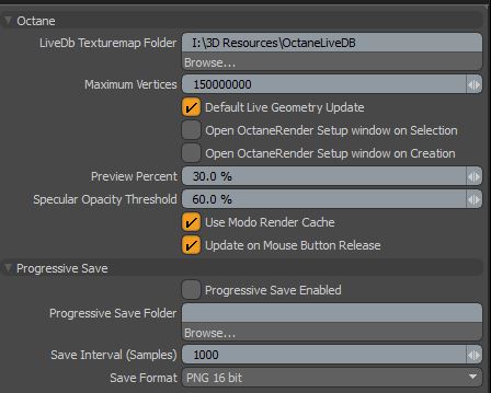

Looks like I already had changed the default value to this in a desperate try.

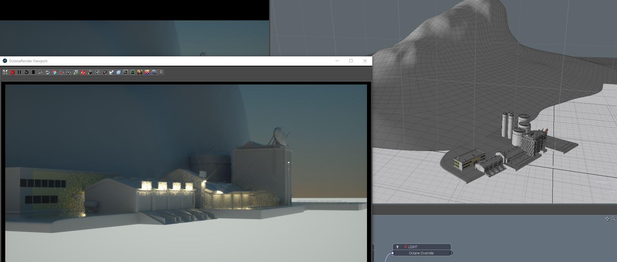

I hid some layers. The issue might be because of a specific object. I'll investigate that later.
However, What I see now is some really odd placement..
See the mountain in the OpenGL view. It's swallowing the buildings in Octane render. None of the objects have any transforms. They are all CC subdiv level 2.
150 million is probably too high - since that will require a huge chunk of RAM. I suggest 50 million (if you have plenty of RAM), and only increase if the plugin pops the msg saying there are too many polys. 11 million polys will be 22 million triangles, requiring 22 million vertices, so setting the value to 25,000,000 should work too.
I notice you have Use Modo Render Cache ON. There have been many bug reported to TheFoundry on the render cache, so in general I only use it as a last resort (if you need micro-poly displacement for example). Turn it off and see of the problem is resolved.

Ah, that did the trick.
Thanks man!
