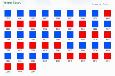

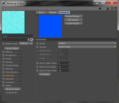

I'm using a .bmp sequence, ive named all of the frames accordingly, ive set the frames in octane properly (i assume), yet it still doesn't work. I've attached a screenshot of my material settings - there's only 47 frames in the sequence. It's supposed to be flashing police lights.
Thanks for any help.
Texture Animation Settings

It should work fine on latest builds. Which version? How is file names? Where they are stored? Be sure you don't have a image as first frame in tex folder or searchable folders.

Files names go as follows: First frame is named "0000.bmp", then it goes "0001.bmp" "0002.bmp", and so on.
I've put them in a different directory to the "tex" folder. Screenshot below of how they're set up.
