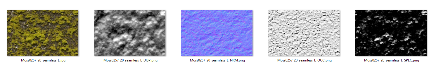

Maps
Maps

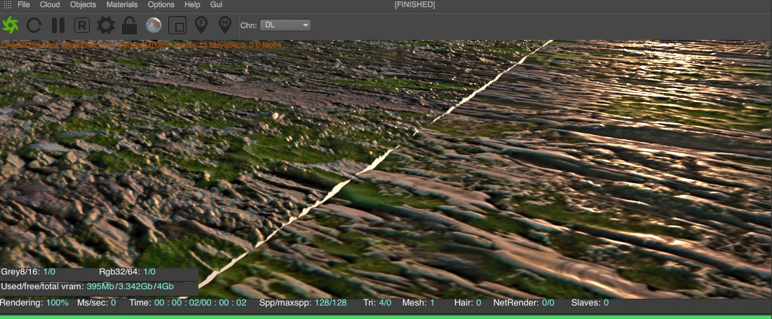

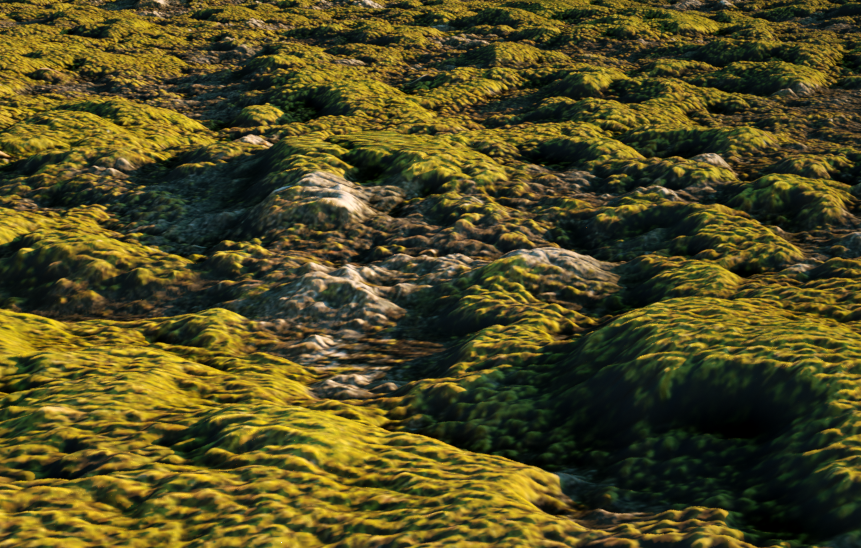

This is how the render is looking

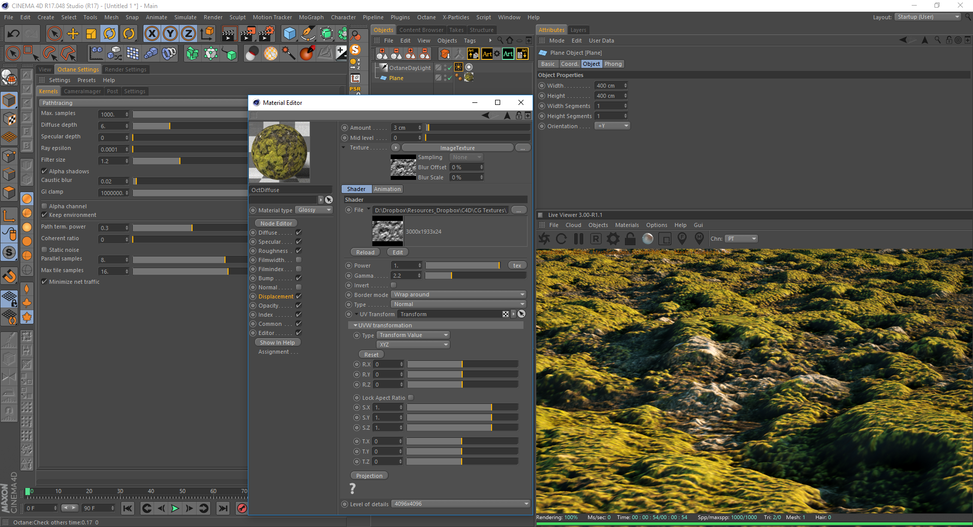

My C4D Setup. Tried subdividing the plane more, but it didn't make a difference.

In general, the classic displacement map has the great deformations while the fine details are stored in the normal map.
Octane Displacement is a bit different, it gives the best results if the major deformations and the fine details are stored in the same map.
CrazyBump with default settings works in the classic way and tends to blur the displacement. Here is a fast example with a generic 2k texture converted in CrazyBump:
CrazyBump_01.zip
(3.93 MiB) Downloaded 195 times
On the right the classic CrazyBump output, on the left the displacement is obtained by converting the CrazyBump Normal map into bump with Photoshop. Obviously the more resolution you have, the more you can go near the texture.
