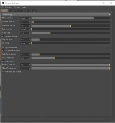

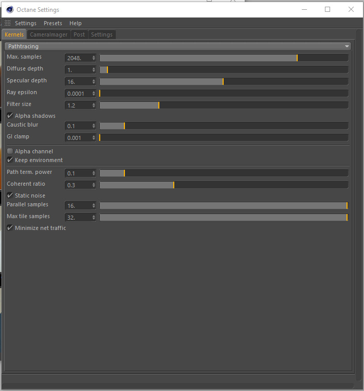

Here are my render settings (I have fake shadows on as well):
The issue I'm running into (which you can see in the test render above), is that the reflections are a bit noisy, even at 2k samples. I've tried bumping it up to 4k which really starts to give me diminishing returns, especially since I'm hitting render times of about 18 - 20 minutes there.
Although I don't have a deadline for this, I wondered if anyone has some suggestions on how to cut down on the grain in the reflections and or cut down on render time, otherwise I'll be rendering this for the next month.

Hi Ian,
since the kernel settings are quite extreme, have you tried in DL None mode?
the emitter materials have to cast lighting?

Hey Beppe,
I have tried the DL None mode, BUT I did not think to turn off cast lighting on the emitters, great idea.
It looks like that did the trick and it cut the render time in half, so I can effectively double the samples for Direct Lighting.
Thanks a lot, that's exactly the suggestion I was looking for!
