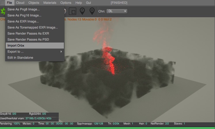

In c4dOctane you can also import directly an .orbx material from the Live Viewer menù by clicking on File/Import Orbx:
