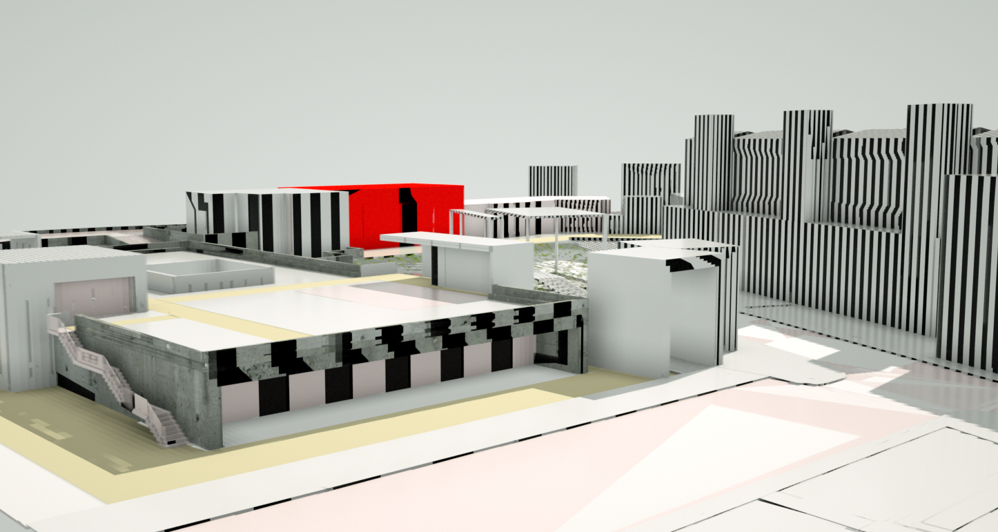

I don't know why those textures are black and white, and others normal. (see Attachment)
If you can help me, I shall be grateful.

did you assign them any material? can you adjust the ray epsilon parameter and see what happens?

before I have done material and now change Ray Epsilon.. But nothing.
for some faces it worked but most remained white and black.
It' s so complicated... I used octane for 2 years and never encountered this problem.

Make sure you have all the geometry UV mapped (use the InfoChannel Kernel->Type=Texture Coordinates).

Thank you Paul, i dont know why, but i solved.
I moved into origin of model the objects, because before they were far from ' origin.
