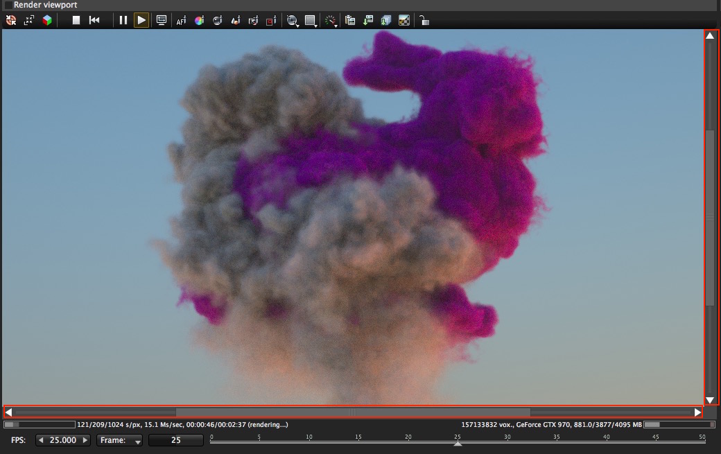

Hi NeoCortex,
if the rendering resolution is grater than the monitor resolution, you should see a couple of bars in the viewport borders to navigate the render buffer:
You can also use crl+LMB for navigate the frame.
ciao beppe

I got it working now Thanks I appreciate it :D
