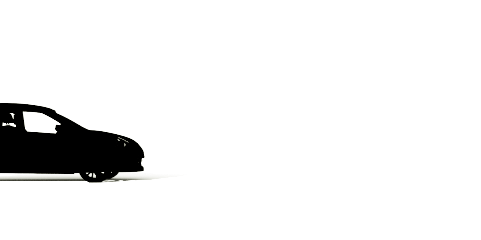

Those are the 2 alphas I rendered:
Shadows are bad because of over exposing to get rid of the blue sky
Beauty Render
Blended with first alpha in photo shop with some manual editing to get rid of the blue sky
What do you think? how should I go?
Shadows are good but Blue sky is visible
Beauty Render

well, I see the problem, well the "alpha" trick was intended for background removal, in your case you'll need 2 passes, first one should be the standard all black with white enviroment for background, then an extra one with skylight for the correct shadows where your car (in your case) should be all diffuse black, and the matte objects, aka the rest all diffuse white, balance the sun power to not get too overexposed shadows and blend both pictures to take the sky off.
Hope this quick example helps
Great Idea, I will try it right away
