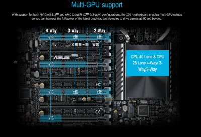

I'll be short - very busy today: 28 laned cpu works only with 4 gpus on dual PLX mobos (3 of them: asus x99 e ws - pure shit, asrock ws e, asrock x9 extreme). On other boards 28 laned cpu will cut some pcie slots... All about it is in any manual of any motherboad. If you go with 3 of the above mobos sure 28 laned cpu will work. I've already build... dozens of watercooled workstations and it there is any possibility avoid asus...too much to talk about it.
When you have time please explain about asus x99 e ws because i think of buying it. And about asus as well.smicha wrote:I'll be short - very busy today: 28 laned cpu works only with 4 gpus on dual PLX mobos (3 of them: asus x99 e ws - pure shit, asrock ws e, asrock x9 extreme). On other boards 28 laned cpu will cut some pcie slots... All about it is in any manual of any motherboad. If you go with 3 of the above mobos sure 28 laned cpu will work. I've already build... dozens of watercooled workstations and it there is any possibility avoid asus...too much to talk about it.
i7 10700k | Win 10 64 bit | RTX 3090
Asus has the worst support on the planet, seriously. If anything goes down you may wait at least a month or much longer or never see a new replacement. They completely ignore your requests as for bios improvements. If you have to have x16 on 4 gpus go with Asrock ws e or Supermicro.
