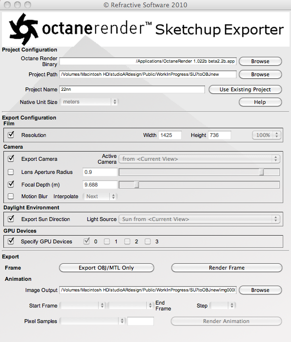

sorry for the delay... it's more or less like the previous one: it works, loads correct defaults, remembers values/boxes on save-file... but still I can't change the resolution and GPU switch is greyed out (but this time I get only GPU #0 checked and not all of them - nota that I am running both my graphic cards atm)

MacBookPro unibody 2x2.4GHz | 4Gb | 9400M+9600GT 256Mb | OSX 10.6.8
i7 2600-K @3.4GHz | 8Gb | GTX560Ti 2Gb | Windows7x64 | Octane 1.0 b2.52

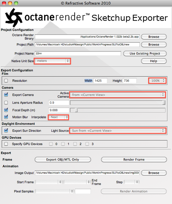

Clearly the % pull-down and the GPU checkboxes should all be changeable - so something is wrong with the way the MAC is interpreting their 'disabled' status
It's not so clear from your image - can you test this please...
If you click the left-hand Resolution checkbox to become unchecked do all of the options to its right 'gray-out' [=become 'disabled']?
If you click the left-hand Resolution checkbox to become checked do all of the options to its right become 'enabled' [=text fields are editable]? The % drop-down should be enabled too - but I can see that it isn't on your MAC ?? I also see that the other pull-downs look disabled too - time for some alternatives...
If you click the left-hand main GPU checkbox to become unchecked do all of the numbered GPU checkboxes go unchecked and disabled [grayed-out] ?
If you click the left-hand main GPU checkbox to become checked, then by default checkbox '1' should become auto-checked, BUT thereafter you should be able to change any of the four settings until the main one is unchecked when all four should all become unchecked and disabled...
With other checkboxes - when toggling them on/off does that affect the disabled state of the options to their right ? When a checkbox is unchecked its options to the right should become 'disabled'/grayed-out [except the two sliders which have proved to be 'non-disable-able' even on a PC!]. When it's [re]checked its options should become 'enabled' again.
Thanks again for the help - I hope we can shortly get all of these MAC niggles resolved... After your reply I'll look at some alternatives to try and fix this final annoyance......

Resolution: same behavior either if checked or unchecked (can't type in text fields, can't even select default numbers via double-click or click-n-drag... while I can select UI text - see attachment)
GUPs: if unchecked all # become unchecked and grey; if checked only #1 is checked but greyed-out and I can't select/deselect it (or anything else)
All the drop-down windows (red rectangles) are disabled/greyed out no matter if the main property is toggled on or off
cheers,
A
