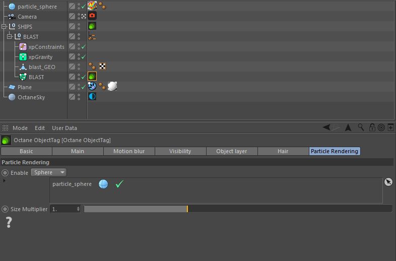

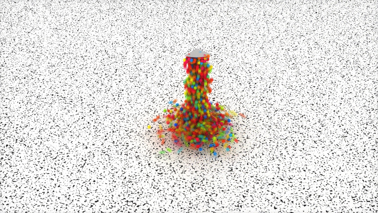

when rendering "x-particles" with "Octane ObjectTag" and using an object (here i.e. sphere) in the "Particle Rendering"-Tab, the motion blur seems to go right for the first frames to render and gets more and more confused over time. is this the known changing vertex count probelm? Or is there a solution? Maybe there is a way to use the x-particles speed and direction parameters...?
Thanks for your help. Keep up the great work.

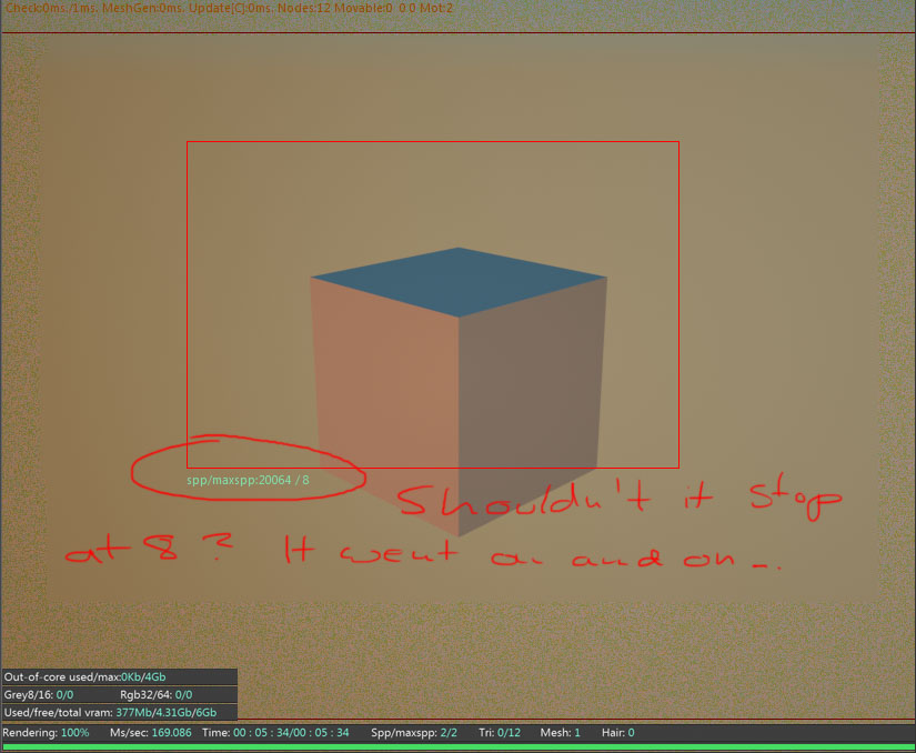

Hi Aoktar, thanks for your work, in generell everything works very stable and i appreciate your work on this plugin very much!
i noticed that rendering in the live viewer a render region, it keeps rendering on and on and on. I dont mean just more samples that for the whole scene as it has been before, i mean it does not stop rendering until i pause it.
Using newest Versions of plugin an Standalone.
I can reproduce this behavior with a simple Cube and daylight scene. DL and PT, set them to 2 samples and with render region it renders to eternity :lol:
Anyone else? Any suggestions?
Best Chris
