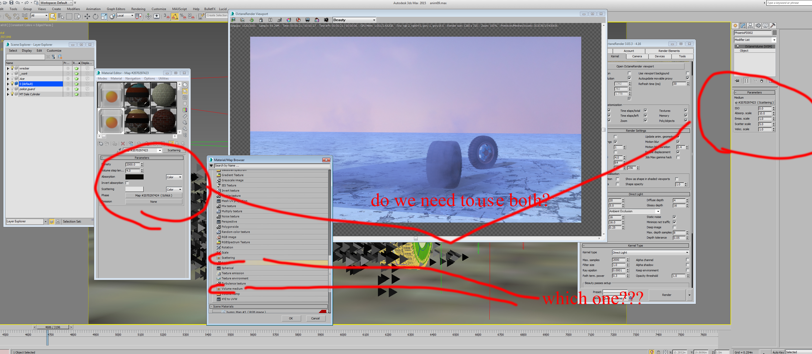

We are using OCtane Volume and scattering medium but we are not sure what is the best proper way to adjust. is it in volume medium or in scattering medium or do we need to use.

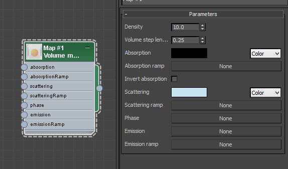

You basically just place your Octane Volume object, select your VDB sequence (and number of frames), and apply a Volume Medium map to your map slot on the Octane Volume. (Map > Octane 3 > Volume Medium).
These settings work great for the kind of smoke I've been making (creamy milk type smoke). The only thing you really vary is the Density and Volume Step Length.

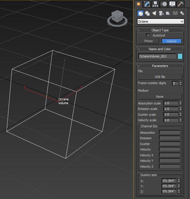

Also, when you make the Octane Volume in max, you just go to the first create tab and at the bottom under Octane, create a Volume like you would a primitive. It'll look like this:
