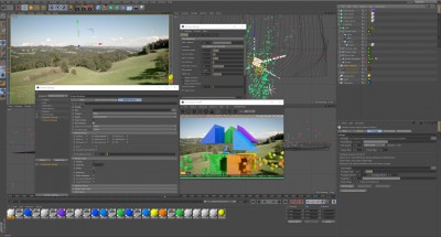

Guys, I need your help since I’m pretty new to Octane within C4D and there is one thing I can’t handle: shadow with a camera-tracked scene. Hope you can help me with some hints.

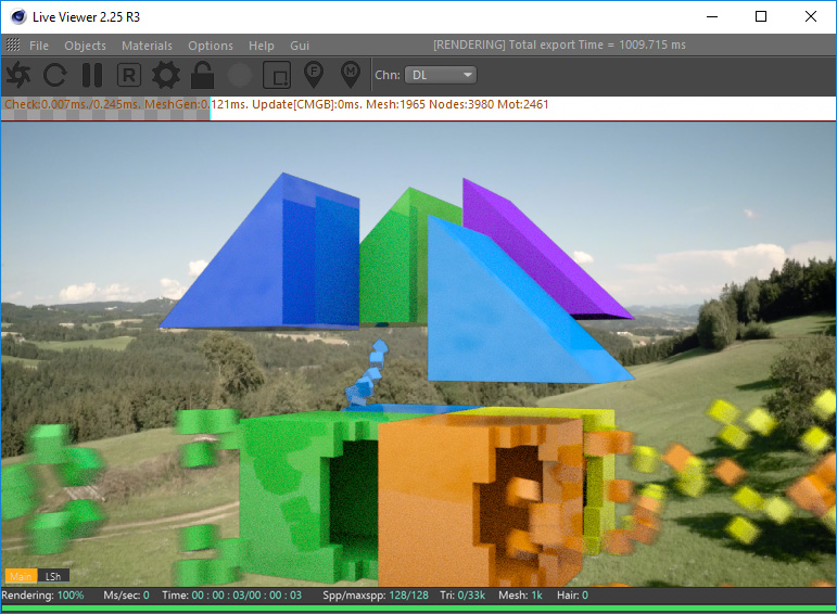

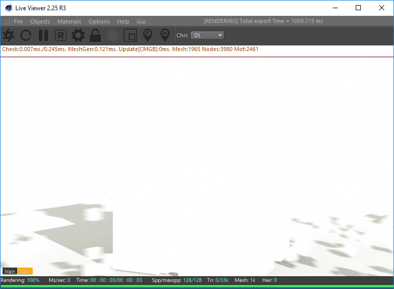

After studying the online manual help many times and also watching the tutorial about render passes of inlifethrill (https://vimeo.com/119848103) many times I’m asking how to get displayed the Main (Main) AND the shadow-pass (LSh) AT ONCE in the live-viewer. I can’t imagine that there is the only way to switch either the image (Main) or the shadow (LSh) within the Live-Viewer without getting the possibility to see the whole picture (without rendering as a file and doing a compositing in After-Effects).

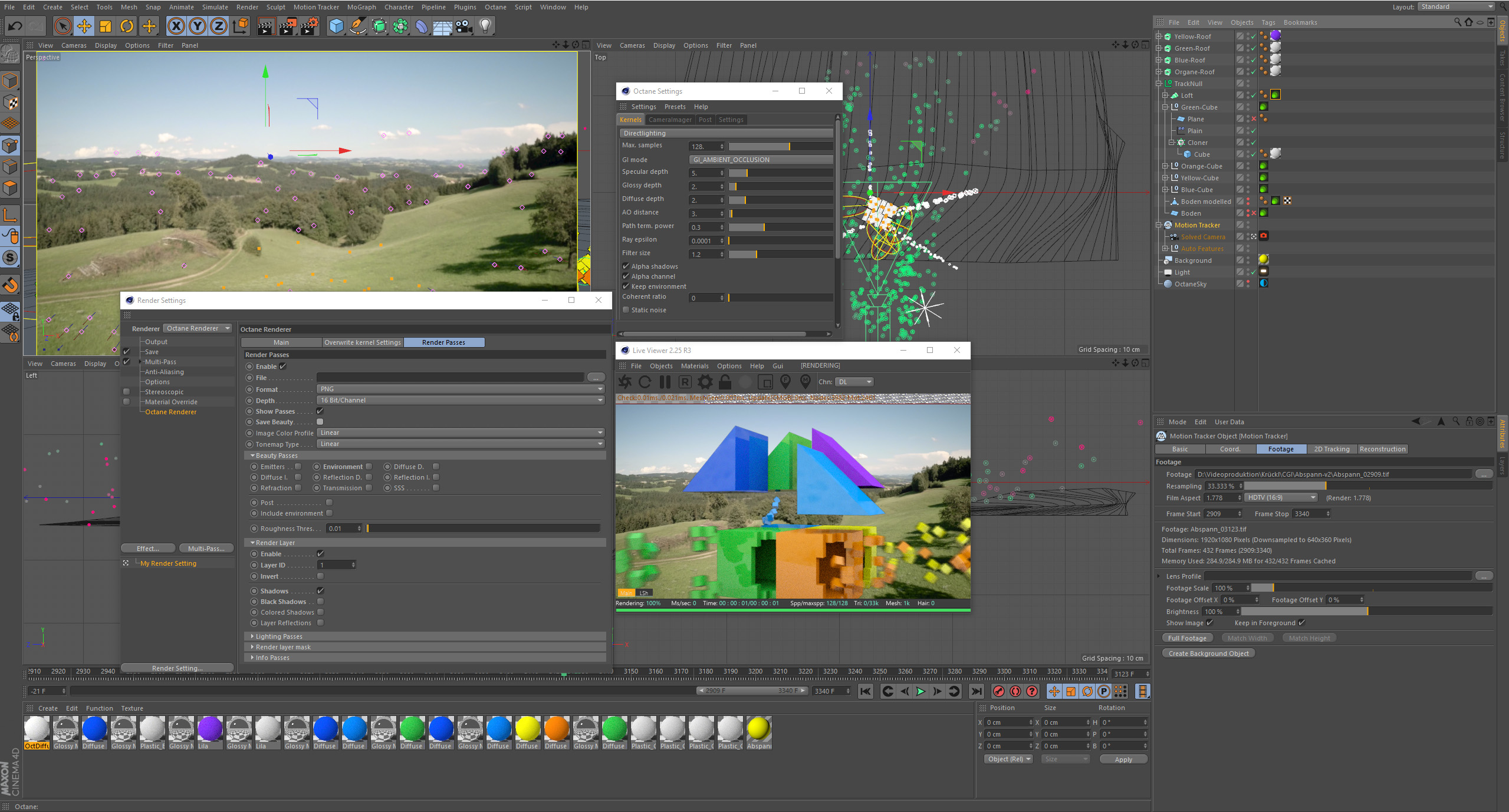

Here is my story: have tracked a camera-sequence within C4D and within that scene there should be build up the customers logo – strait forward. The logo itself is on a plane which should simulate the shadow. Create a background object and but the scene into a material – enabled the Alpha Channel so that you can see in the Live-Viewer the Scence itself. Put the Octane-ObjectTag with Layer-ID 2 on the plane (to simulate the shadow), everything else is on Layer-ID 1. Enabled the Render Passes, Enabled Render Layer, Enabled Shadows – everything works fine, looks good, shadows are rendered – BUT I have to switch on EVERY image between (Main)
and (LSh)
on the Live-Viewer to control the shadow – and get only either the image or the shadow – VERY BORING – is there really not any function to get the final rendered image with shadows in the live-viewer? Have I overseen something – I guess - I’m using C4D R17 – Octane 2.25 R3 – I did a screenshot of all necessary information.
MANY, MANY THX for any response!! Cheers, Robert

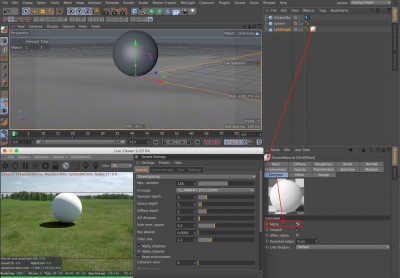

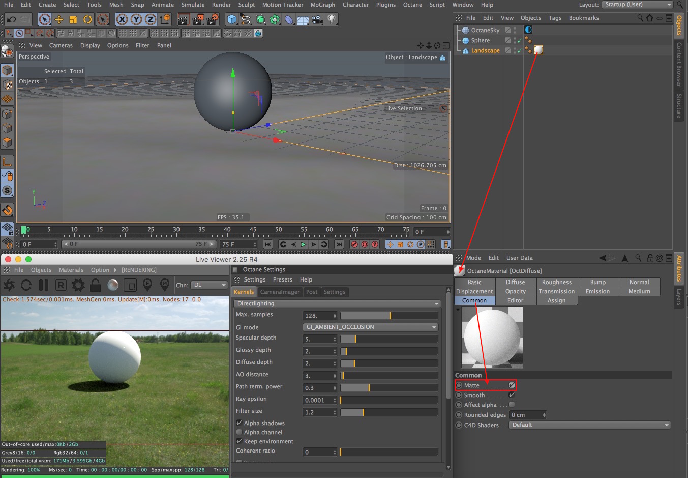

Hi rjohn,
in general, Render Layers are intended to the final output. For fast preview, you can use a diffuse material with the Matte option active in the Common section:
ciao beppe

bepeg4d wrote:Hi rjohn,
ciao beppe
Hi Beppe,
MANY, MANY THX!! YOU made my day - works perfect!! Thanks a lot!!
