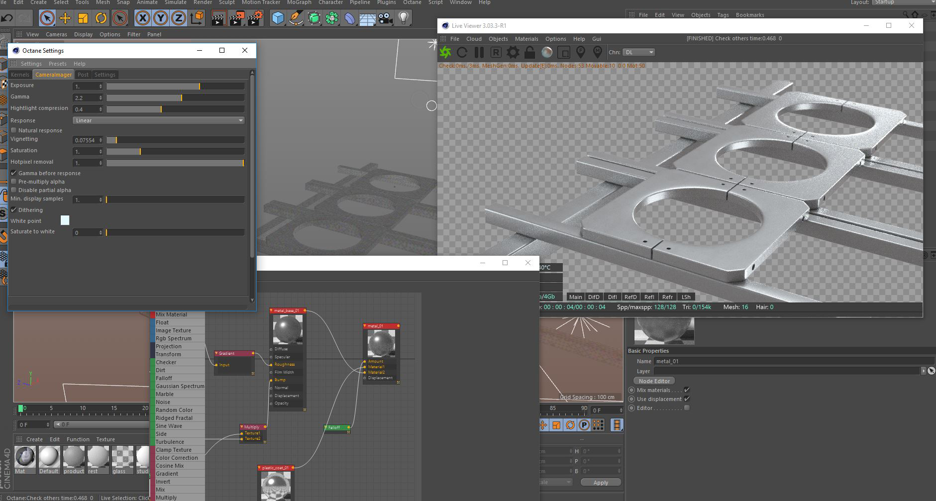

Hey,
when i turn my gamma in the cameraimager to 2.2 the material is too bright and differs a lot from the material preview.
Any suggestions?
Env. is on 50% v.
kind regards!
Posts: 10632
Hi Chillkroete,
the material preview is in neutral condition, while in every scene there are particular lighting conditions, in your case I see an emitter, right?
What happen if you simply reduce the exposure value?
ciao beppe
dotJack
Posts: 13
Joined: Mon Aug 10, 2015 8:14 am
Location: Tallinn, Estonia
Metal, much like glass, is all about the lighting and you can make the same piece of metal look completely different by moving a single light.
On your surface i can see that there's a light on the other side of the object (Camera -> object -> light), which you can see in the reflection.
You can of course turn down your material base colour but also mess around with the falloff node. I think that your base metal (without the completely shiny fresnel), could be quite a bit darker so it might just be your super shiny metal that you're adding on top, that's brightening your scene up a bunch (specifically because of the lights and the low viewing angle).

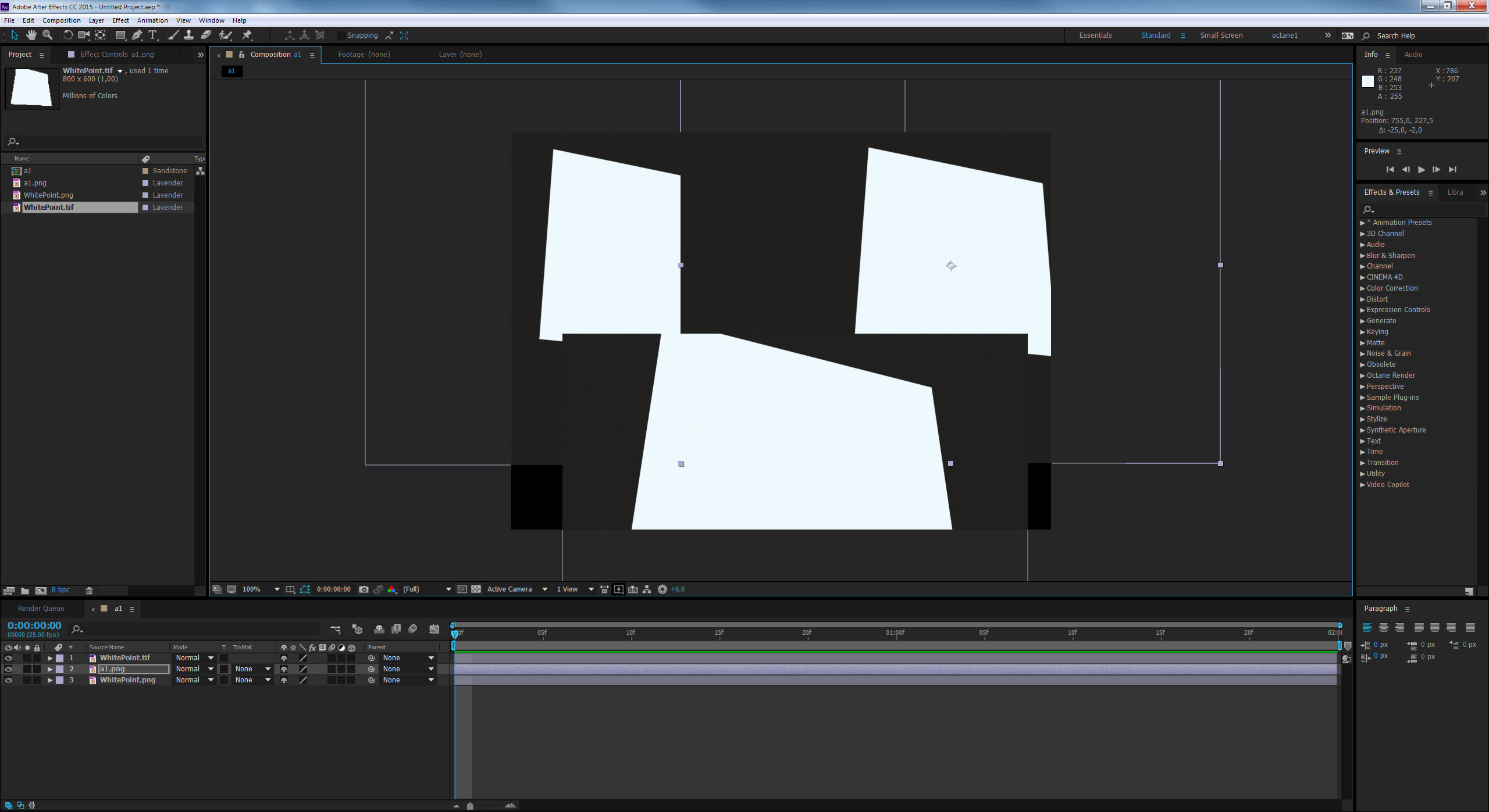

milanm
Posts: 261
Joined: Tue Apr 30, 2013 7:23 pm
aoktar wrote:Hey,
issue is not clear to me. But i haven't change anythings about color picking or white point since lot of versions.
Hi
I rarely use it so I guess I didn't notice the problem before. I think it could be sRGB to Linear conversion or something like that. Basically, the color that is being picked up is wrong for some reason. Rendering is Ok but it's the color picker that works differently between plugin and standalone.
Picked color in C4D seems darker :?
Color picker in C4D gives this result:
Color picker in Standalone gives this result:
Edit: I tried do explain better. Sorry for the confusing scene file.
Regards
Milan
