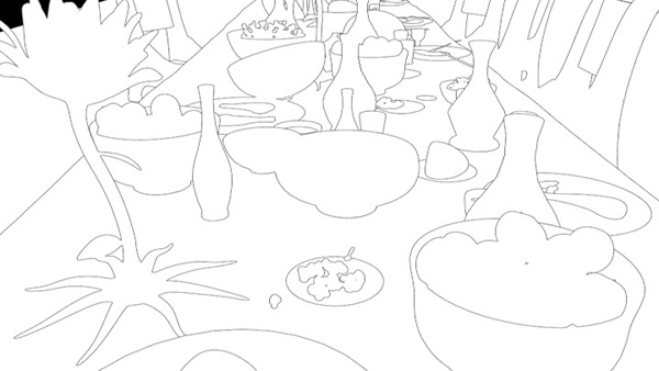

Also to extract filtered masks from aliased passes,we need a coverage pass, which octane doesn't have,
coverage pass contain the filtering information :
However without coverage pass, we can still recreate filtering for extracted mask with an older technic:
render aliased pass at twice the resolution, and down scale the extracted mask.

I have been thinking about the coverage passes and I don't think the original concept (storing the pixel coverage of the object ID with the largest coverage) can be implemented reasonably in Octane, we could do something that works similarly (storing the pixel coverage of the object ID that is at the center of the pixel), but I don't think it will be good enough to extract useful anti-aliased mattes from it. There is also the "cryptomatte" system (viewtopic.php?f=33&t=55253) which might be more useful since it allows the separation of multiple objects/mattes per pixel. So the questions I have are:
