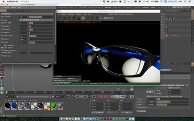

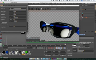

I use Specular material
when checked alpha channel but see environment over the glass material
why?

Hi D994083,
you need to go to the Common Tab in the attribute of the specular material and tick the "Affect alpha" option:
ciao beppe
