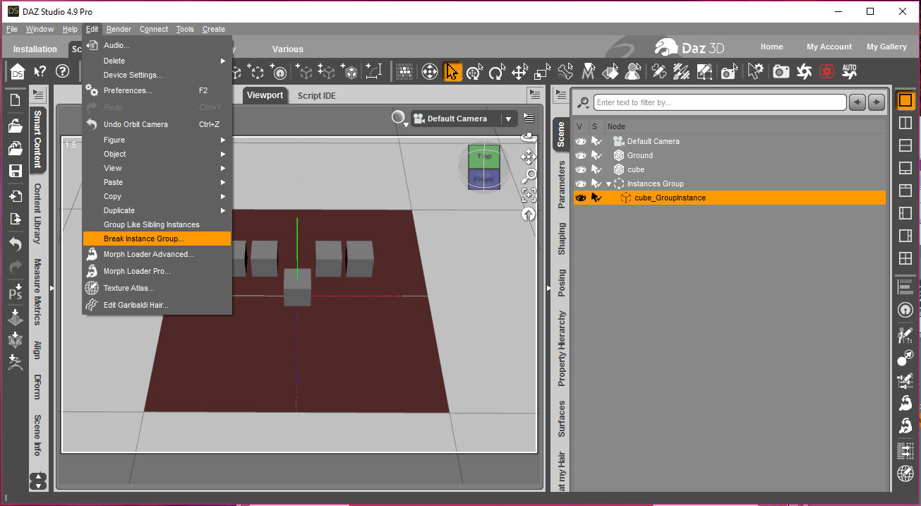

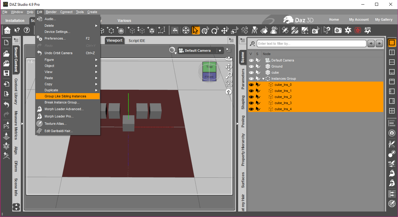

3. Select all the 5 instances in the scene panel and click "Group Like Sibling Instances" under the Edit menu.
Select instances and group them
4. DAZ Viewport continues to show 6 cubes and in the scene tab it shows the grouped "cube_GroupInstance"
DAZ Viewport after grouping.
But Octane Viewport now shows only 2 cubes:
Octane Viewport - grouped
Now it may be because the Octane plugin is wrongly reading the coordinates and rendering them all at the same place instead of taking the individual coordinates of each cube like DAZ is doing or it may it is actually not seeing the other cubes.
If I select "Break Instance Group" under the Edit menu, the 6 cubes then immediately become visible in the Octane viewport.
