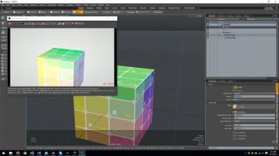

Hi Paul,
Thanks for looking into the UV/Static Mesh issue. Unfortunately I still get missing textures in Octane with the build you just posted. Creating a simple cube with a diffuse color texture (default settings for everything) still renders without the texture in Octane, once converted to a static mesh.

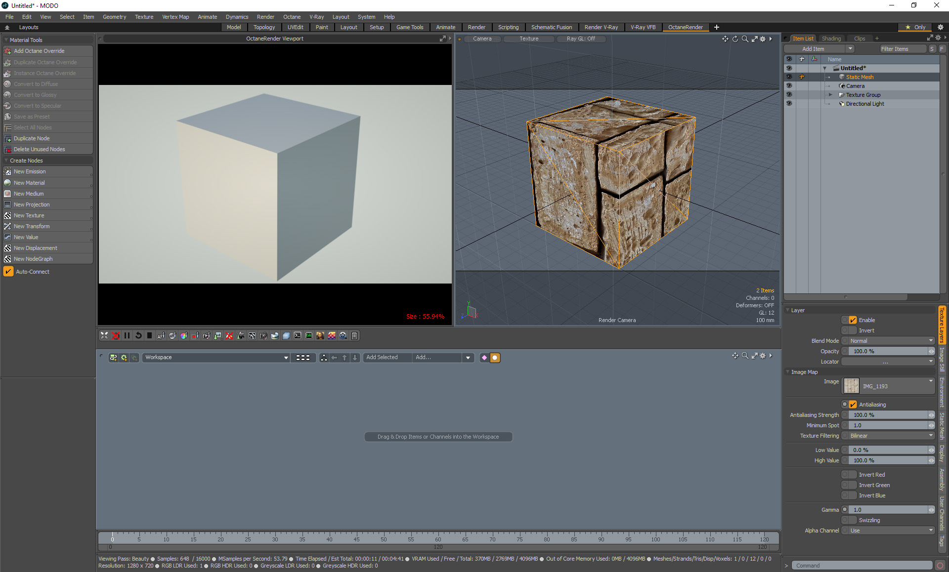

It is working for me. Is it possible there was a problem downloading or installing the update?
Paul

The moment I convert the mesh to a static mesh the texture no longer renders.
Kit version says: OctaneRender (version 3.3.1.112.901) I tried uninstalling and re-downloading/installing again.
I've tried disabling V-Ray to make sure it doesn't interfere somehow. But I still don't get the texture on the static mesh in Octane.
