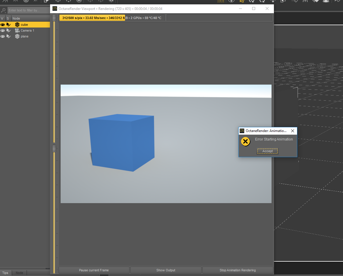

Hi Paul,
Came across a bug I think. Rendering animation fails when you use a Render Setting from "My Presets".
DS4.9 and OcDS 3.3.2.23
Regards,
Ben
