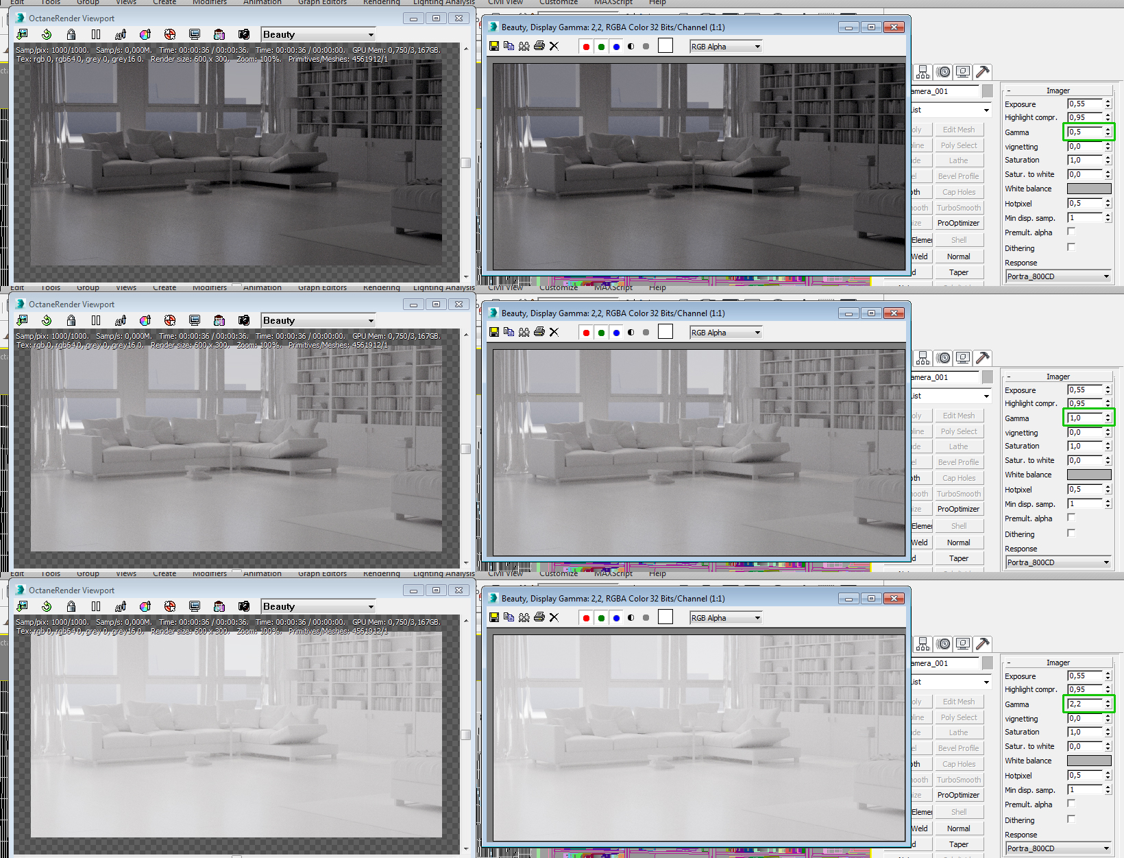

Ok, I've read this info but my problem persists.
So, let's clear thing out:
In OCTANE 2.x we have possibility to change Camera Imager Gamma, which affects rendered and saved images.
Example is here:
So, porting from OCTANERender Viewport to Max Fremebuffer works correctly, saving too.
This workflow in some way is described in this post:
viewtopic.php?p=261462#p261462

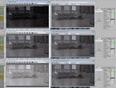

But in OCTANE 3.X this doesn't work in any way:
Option 1. Disabled 3ds Max Gamma - OCTANE Render Viewport responds correctly, but porting to Max Framebuffer always changes image Gamma to 1.0.
Example is here:
Option 2. Max Gamma is Enabled - OCTANE Render Viewport doesn't respond on Imager Gamma changes.
So, in fact it looks like Camera Imager Gammaa is useless at this moment, because there is no way to save image looking exactly like in Octane Render Viewport.

kcpr-raffaEl wrote:Ok, I've read this info but my problem persists.
Example is here:
Example is here:
